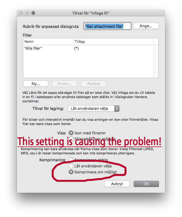

The corrupt file 2...(n) is because they are still compressed. You must append .zip to the file 2...(n) and then unzip them. -

In this moment I have done tests on an minimal database, in purpose to recreate and find the 2..(n) problem. I have found the reason! I have a script - adding the attachment where the script step is "add file"! IF YOU SET "compress if possible" the attachment will be corrupt - HERE IS THE REASON ! I hope this analysis will help, and to find a solution - It would be wonderful if this problem could be fixed. Phuuu -

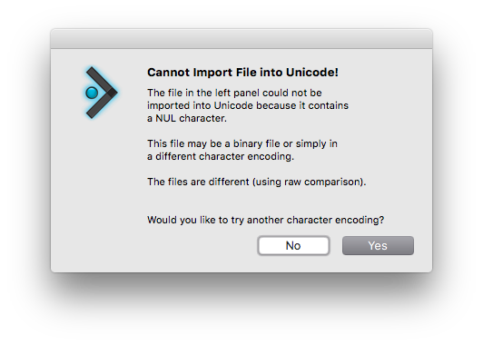

SPECIAL NOTE - About the corrupt No 2 attachment - Issue. When comparing the attached file No 2 to the original by using DiffMerge program I've got a error message - see picture. When comparing the two files open by BBedit - there is no difference "inside" the files. Please let me know if I should send the corrupt pdf-file to anyone by mail? -
