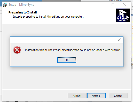

Upon install, I get an error 'Installation failed: The ProscTomcatDaemon could not be loaded with procrun"
When attempting to install MirrorSync on my Windows 10 Pro, I get the following error:
This is the free one-device download version that I'm trying to test.
Please advice if you have any suggestions.

I'm had this very same problem while installing 360Works 360Deploy2 - replacing my Java installation with AdoptOpenJDK JRE 8 fixed it!
