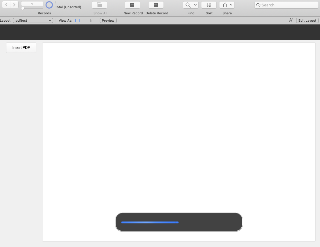

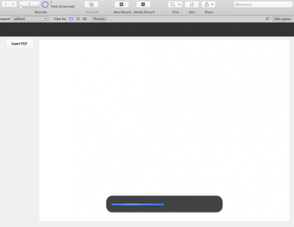

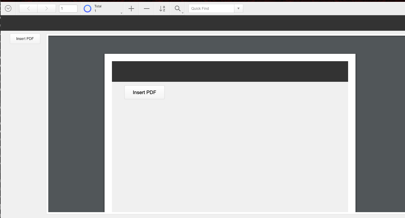

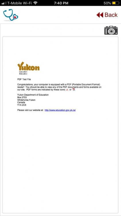

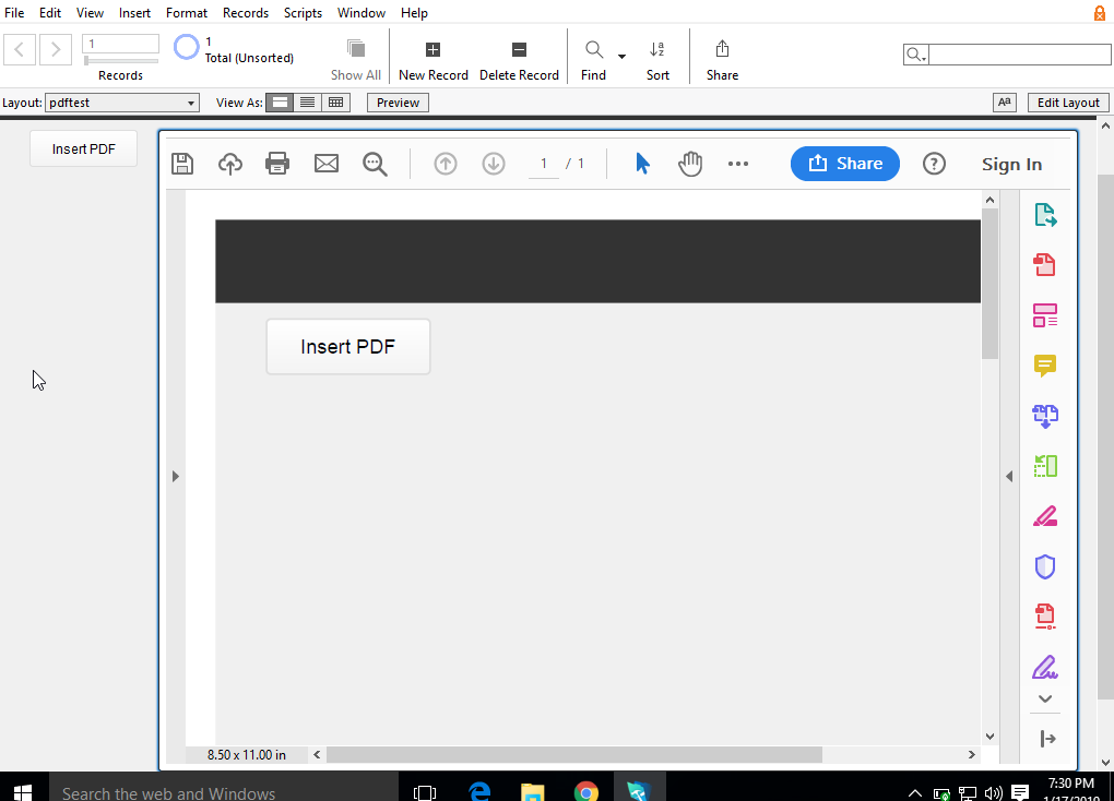

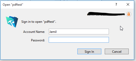

I designed two completely different databases, one in each scenario and both have had the same issue. As i am designing the database (locally), i am able to upload pdf files and view/interact with them perfectly. However, as soon as i upload it to the server, i loose the ability to view/interact with pdfs anytime i connect via Filemaker Pro from a mac computer. The rest of the database works perfectly fine, scripts, layouts, fields etc. It works perfectly fine if i connect via Webdirect, Filemaker Go and Filemaker Pro (Windows Only); In any of the previous scenarios i am able to view/interact with pdf content. The only connection that gives me issues is via Filemaker Pro from a mac.
