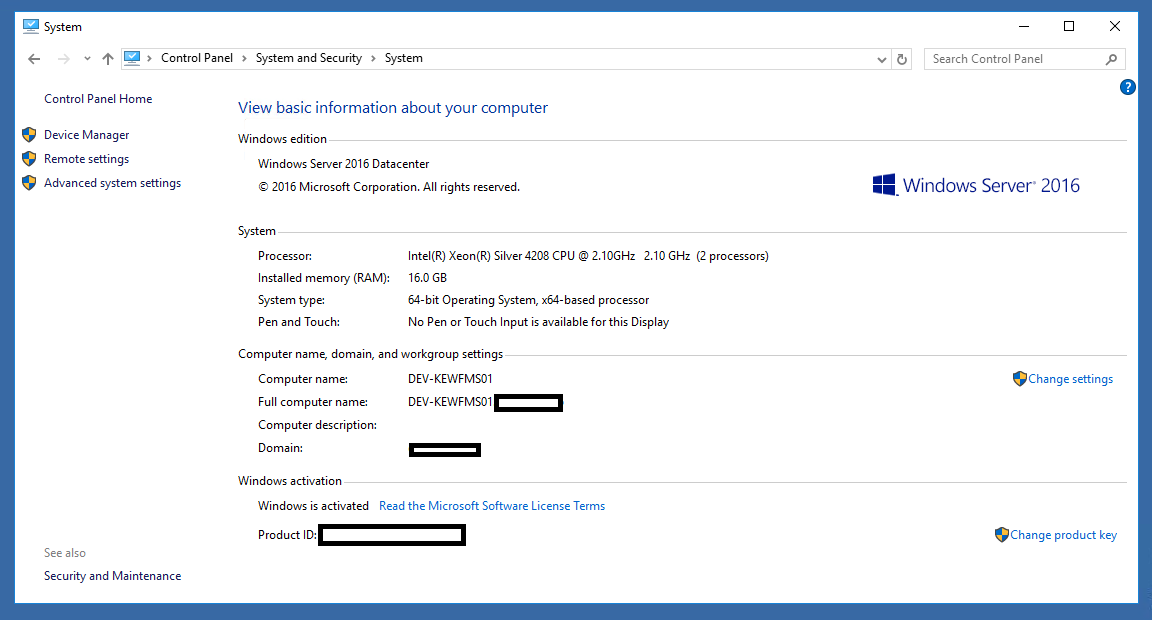

The OS the server that FileMaker Server is running on is Windows Server 2016 (we're upgrading to Windows Server 2020 later this year). See the following screenshot;

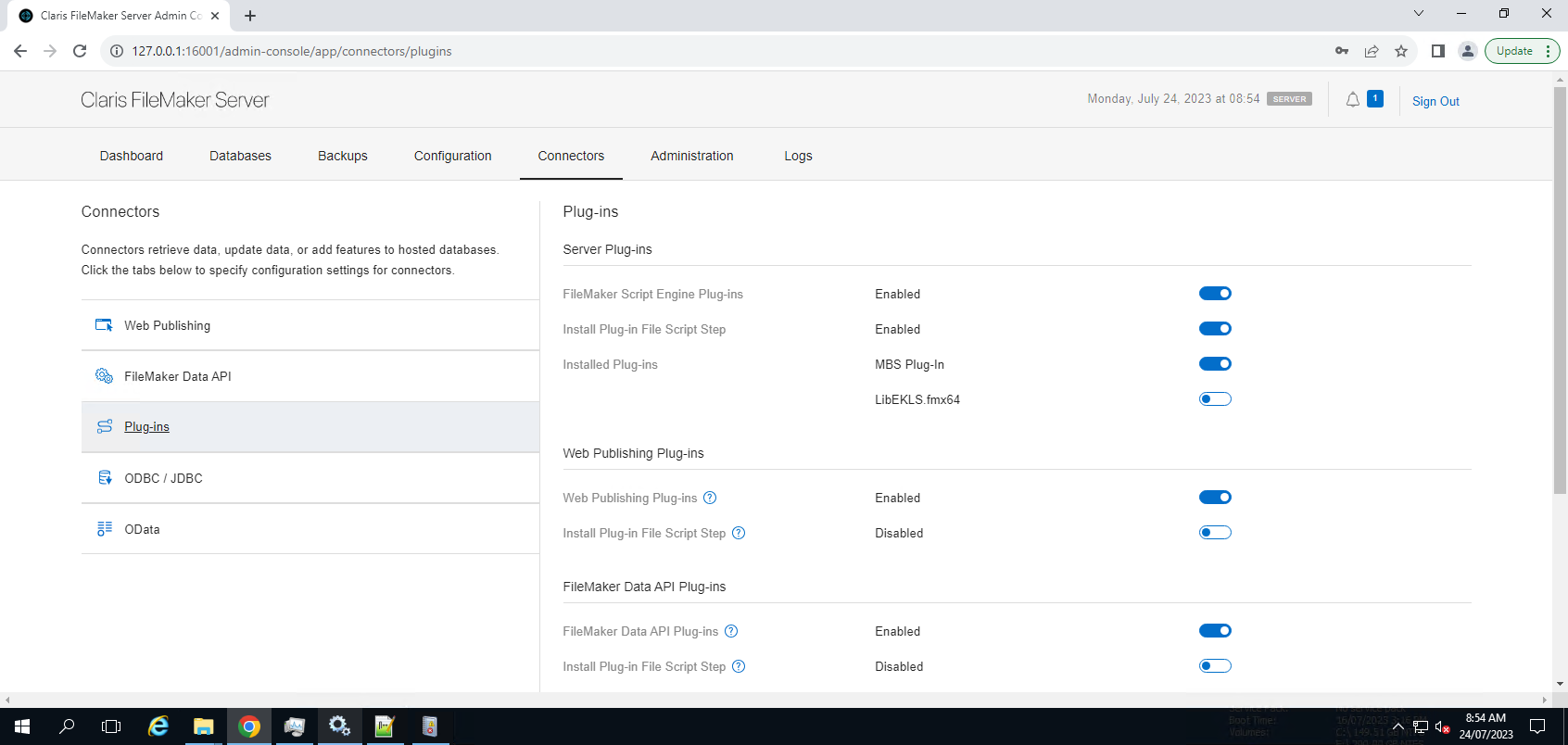

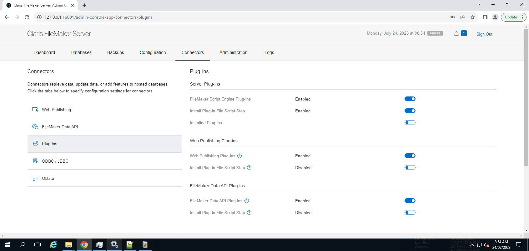

Here is what the Plugin dashboard looks like before enabling the plugin;
And after enabling the plugin;

2023-07-31 16:04:44.824 +0800	Information	518	DEV-KEWFMS01	Administrator connected: "kineticadmin [127.0.0.1]" (admin console).
2023-07-31 16:04:55.725 +0800	Error	474	DEV-KEWFMS01	Plug-in failed to load: LibEKLS.fmx64
2023-07-31 16:19:56.558 +0800	Information	520	DEV-KEWFMS01	Administrator disconnected: "kineticadmin [127.0.0.1]" (admin console).

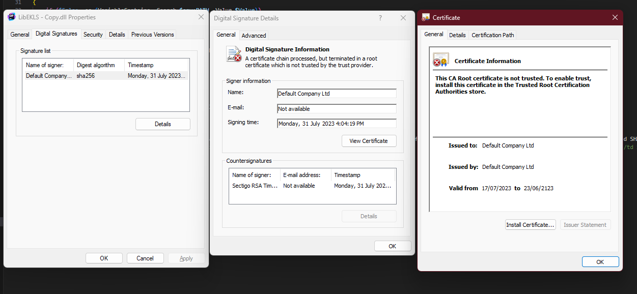

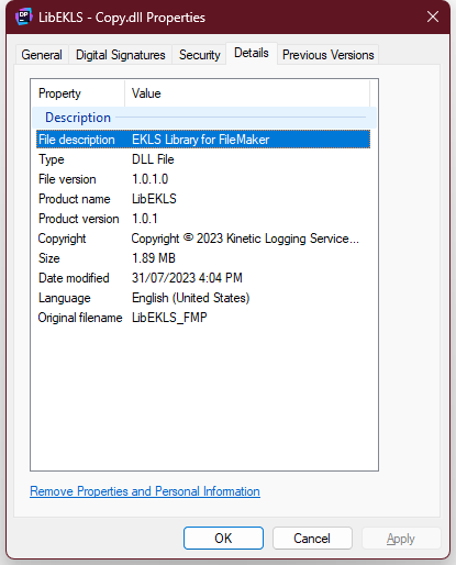

Here's the certificate information about the plugin (renamed extension to .dll to see this)

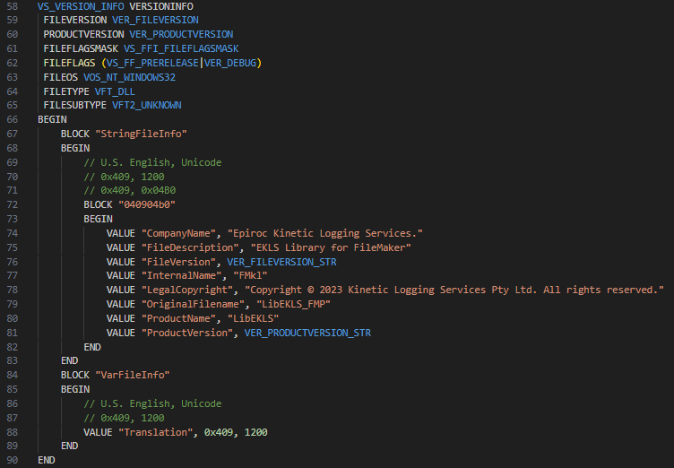

I've also set all the fields on the .rc file to what is given in the PluginSDK MiniExample
Also the InternalName field in the resource file is the same as the id function when used in rust plugin.
