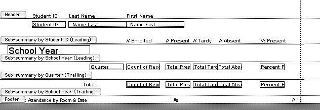

I think your attendance records need to have a Quarter field so that you can sort by that too. Add a Sub-summary by Quarter part to the layout and put the summary Count field on that too.
Using this scheme, you will have to devise an automated way to populate the Quarter field in the attendance table. There are several ways to do this, but it depends on how you are creating the attendance records.

The attendance records are generated one at a time each day by hand. I've created a field in attendance with a pull down for each quarter number, but the sub-summary only shows me the first quarter count. Sorry, I'm having some trouble wrapping my head around sub-summaries.
The basic idea of summary parts is covered in the manual, but your Attendance Report by Student might look something like the picture below. Lots of ways to summarize data on reports, so don't be shy about playing around with summary parts.
Each Sub-summary part on a layout will show up when the records are sorted by the field specified in the Part Definition dialog. So if you have three Sub-summary part-fields, sort by all of them. In the example below, you would have to sort by Student ID, School Year, and Quarter in that order, for the Sub-summary parts to show up properly.
(Sorting by Student ID works fine for one student's attendance records, but if you are running this report for a whole class, you can sort by additional fields to make it easier to handle the paperwork. Like a sort by Student Name Last, Student Name First, Student ID, School Year, Quarter.)
