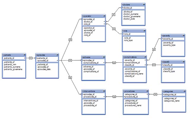

have a db i am desiging to track operations performed on patients, the patient side of db and procedures are joined togther
i am having trouble creating records in the join table using value lists from the operation db
have a look at the attached db schema - any tips please?
Which table you are trying to add records to, and how are you trying to add them? Through a portal? If so, from which table? What kind of "trouble"?

thx for your reply, subscribed to filemakermagazine over the weekend and downloaded some of matt petrowsky's videos which explained what i needed to know
what i have down is use scripting to take values from one form to another, create a record and return to the main form with the new record showing in the distant portal
thx again for reply
