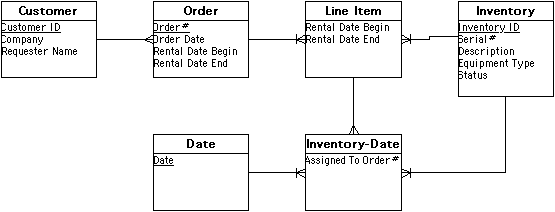

Below is an ER Diagram showing a proposed structure for your system. There may be other entities and relationships needed, but hopefully it will give you a starting point. The idea is that when you are building an order, you would enter the date range and select the type of equipment you need, then perform a scripted find in Equipment-Date for equipment of the type specified for the date range, omitting any that are already used in another order (Not sure if this could be done through a relationship or not.) You can then grab the Equipment ID from any found Equipment-Date records, and use that for the order.
When a line item is added to an order, there will need to be some scripting to update the Equipment-Date records for that date range.
