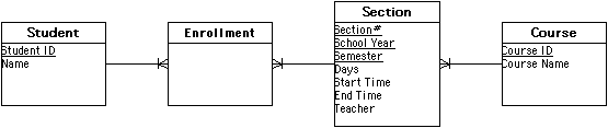

Hi Chap,
You have brought up a good question about how to use dynamic related fields when history must be preserved.
The strategy I use is two-part: Use a School Year or Fiscal Year field as part of the relationship key, and to use lookups to populate copies of certain fields, instead of using the related parent field.
The School Year field helps by distinguishing those things that are unique to each year, like in Section and Enrollment (see below.) Changes to the Room# for "Trig I Fall 2004/2005 Section 1" don't affect other school years. Because the Enrollment file is related to Section by CourseID, Section#, SchoolYear, and Semester, it can look directly at this Section to know what the correct Room# is (no lookup required.)
But a lookup might be used if there are fields that could change over time, but not necessarily from year-to-year, and it is important to know the history of what it was. An example could be Fee, where the rate changes during the year. This may not happen in real life, but lets suppose a school had an "Early Bird Rate", a "Regular Rate" and a "Late Sign up Rate". This could be kept in the Course file, along with a Fee calc that determines which of those rates to use at any given date. The Fee lookup field in Enrollment can then pull in the Fee data from Course when an Enrollment is created.
This is not shown on the diagram, but in practice, you can use global School Year and Semester fields to make filtered relationships to show just the Sections and Enrollments for the selected year and semester.
