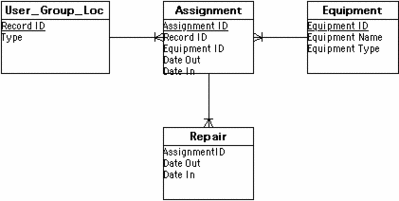

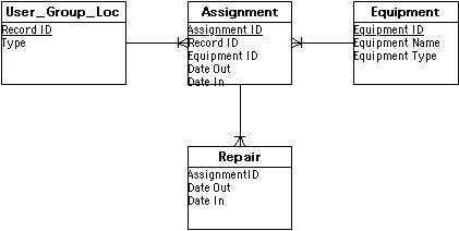

Are you also planning on relating Person to Group (to know who is in each group) and Person to Location (to know where each Person is located)? Or is this not necessary?
If you don't need those things to be related, then I'd probably put the entities together in one table. This will give you common fields of User_Group_Loc ID and Type. Then you would have separate layouts for certain Type specific functions, like data-entry and some reports.
Though this is close to the same thing as you currently have, this design does make some things easier. You can easily run a single report to show which User/Group/Location is assigned to a piece of equipment. You can reuse some common functions a little easier.
I've attached a diagram.
