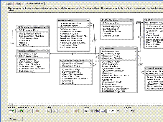

As such I was hoping to use a portal within a portal to relate subanswers to subquestions only to find that you CANNOT successfully place a portal in a portal (or so I've found and read) shocked.gif. The solution seems to be a Cond. Value List. BUT I need to create a relationship between the subanswers and their subquestion so that only the answers for that particular question are listed. I have the value list but the condition isn't activating and I am getting a list of all the subanswers in the subanswer field, not just those for that question. The field I have related, 'subquestion number', is within a portal on that particular layout which seems to be preventing the value list from identifying the value it needs to relate to.
How do I get this to work? What am I missing? If I have to build a loop script instead I will be lost blush.gif
Nattani
PS: I have attached a screendump in word to help. I cannot attach the DB itself due to confidentiality issues.
