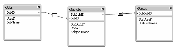

Im working on a new project, and for once I've decided to sit down and plan out my database on paper before creating it in FMA8.
Ive attached a very basic sample of my relationships. In the diagram you can see the relationship:
subjobs------
How do I reverse it so that I can have
subjobs>------status
Thanks as always
Add a Status field to Subjobs and relate Subjobs::Status = Status::StatusName.
The Status table may not be necessary if StatusName is the only field (and it's not the source of a value list.) You could keep the interface for looking up Jobs by Status in a layout based on the Jobs table, and use a global gStatus as the parent key to relate to Subjobs.
Thanks Ender
Thats sorted it.
