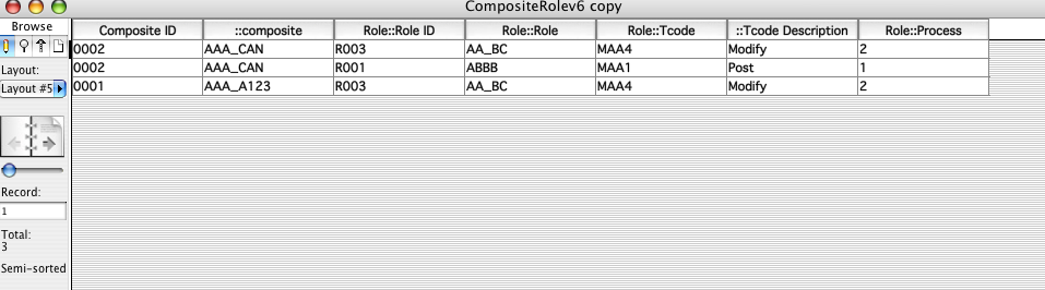

Looks good. Though I'm having trouble when I import records. It does not seem to update the relationship on the portal. Any ideas?
However I did get the data in the format I need, much appreciated. The portals are relaying the data via a new layout that wasn't functioning before :
Orson Scott Card rocks!!
The issue appears to be that the Composite_Role Table is not updating to the new imported records. This isn't something I have to do manually is it?
