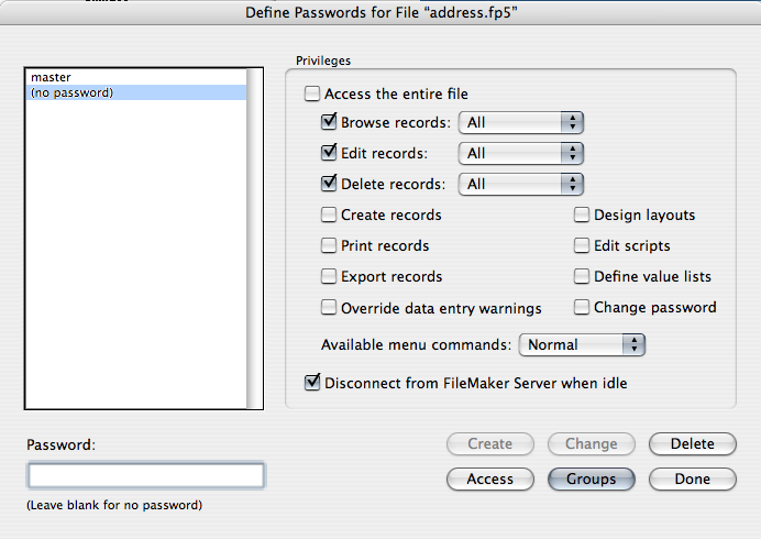

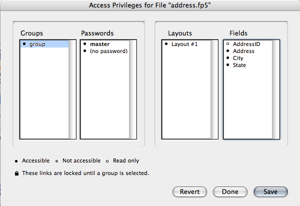

I'm not sure why you'd want to limit your responders to just Vaughan, but I don't think he'd mind if I try to answer this.
It's not clear what you have done to limit access to those fields, but it you look at the attached screenshots, they should help illustrate what you'd need. If you want your "no password" account to have edit access to some fields, but read-only access to others, setup the password to have access to Edit all records (or limit it, if desired,) and set the group's access privileges to the empty circle on those fields that should be read-only, and the filled black circle on those fields that should be read/write.
