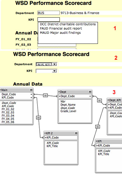

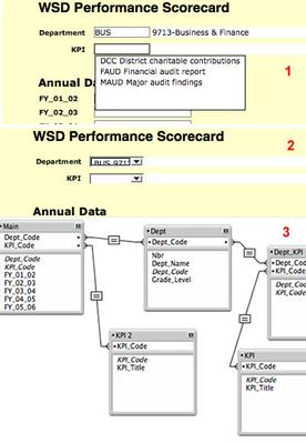

I am not using any scripts. I have related fields.
When I select a department code in the first field (Department), that determines the name that pops up in the second field (no field name), which then determines the list of choices in the field called KPI. I hope that you can see what I am talking about in the attached jpg. In FMP, the relationships work perfectly (photo 1), but when I put the db online (photo 2), the second and third field choices do not display at all. The third picture displays the relationships.
Looking at your screenshots, something certainly looks odd. Specifically, I see "BUS" in the first screen, but I see "BUS 9713" in the same location in the IWP screen shot. I don't know how that could happen. Is it possible that the field is there, but hidden behind something else, like a backing field?
As an aside, I see that your Main table has redundant fields for different fiscal years. You might want to split those out as individual records in a separate table (although that will require more of those relationships!). Then you won't have to change the database structure if you make it to the next FY.
