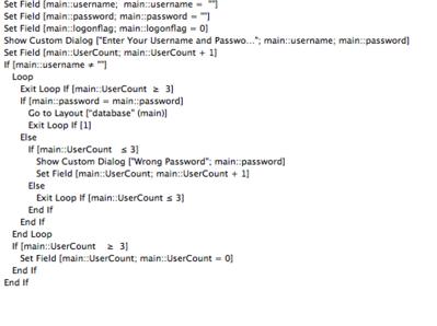

can some one plz help me with this code, im try to get it to log on using to filemaker file, one holding the account and password and one that login there is the code
i am aso having problems using a similar code, if anyone has any suggestions on how to get this working please let us know
I would not recommend a scripted logon since it isn't secure. It's very easy to break so shouldn't be used as a substitute for Accounts and Privileges. With that said, here is a pretty good script for a scripted logon. I tested it pretty good but it's late at night so let me know if there is a flaw.
There is only one account and password in the scripted logon:
Account: John
Password: 1234
Logon.fp7.zip
thx that work and i no now where i when worry thx for you help
