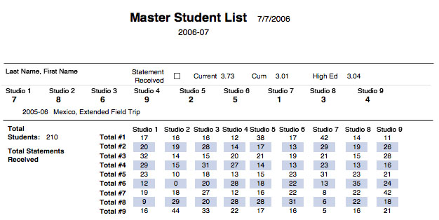

The table I'm working with has records for each student. There is a portal in this layout that lists what number the student ranked each studio. It will always be ranked 1-9. So the portal just contains the field Rank and Studio.
What I need to do is summarize a count of how many people ranked each studio 1,2,3,4,5,6,7,8, or 9.
The other problem is that I want this at the end of a layout. The report above it is a listing of each student and their respective studio rankings.
I attached a picture of how it looks now which is how I want it to look. But I had to create 162 fields just for the totals to work. And I have to change them every year when the studio names change. I figured there's a better way.

Thanks for the reply John, but I'm familiar with subsummary reports. Unless I'm missing something really obvious (which is possible), I don't think I can get what I need with a simple subsummary.
As shown in the picture I attached, the a count of the rankings need to be totaled by Studio and Ranking Number, which gives a 9x9 matrix.
