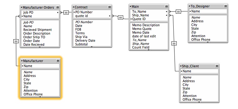

Here is my problem (and I have attached the graph to make it easier to follow):(
Each individual order that gets processed may have more than one supplier providing the materials for the job. To track this possibility I set up the Manufacturer Orders table to be linked to the Contract table which handles the orders themselves. The Manufacturer Order table gets the names of the different suppliers/manufacturers from the Manufacturers table which holds records for the suppliers' addresses and phone numbers. The problem exists when I try to print an order form for that particular job's suppliers.
I have created a layout entitled Order Form Print which looks like the order forms we currently use. When you click the script button that I created entitled Print, it should take you to the exact record you are working on and display the print dialogue box to proceed. Indeed this works on suppliers where the particular record I am working on is their first time in the Manufacturer Orders Table. The problem, however, is that when I am trying to create a new record to print for a new job order with a supplier that has been entered before in a previous job, the print command simply brings you to the original record for the previous job, and not the one I want to print in the current job.

I am also having a similar problem with the Client records in the Main table. Essentially, the main table is used to create and print quotes for a potential client (before they become a real client and get assigned a Purchase Order number). So you create a new record in the Main layout and select the newly added client from a drop down menu that is linked to the Ship_Client table which holds client info. Once again when I go to print a client that has never been entered in the Main layout before I have no problem--it prints that record exactly as I want it. As soon as I try to have a new record display a preexisting client (one that has had a quote generated on it before in a previous record) for a new quote they want, the print command simply goes to print the original record and not the new record.
I think that the reason behind these two issues is that the tables are linked via names and therefore the script finds related records based on the names. However, even though I believe I know the problem I am not learned enought to know the solution.
