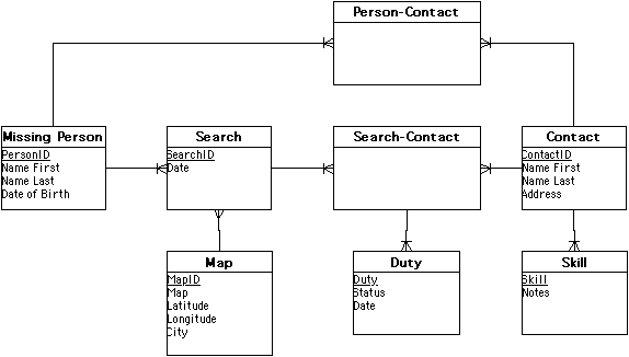

Well I have started getting some reading done. I also have got a start on the database. I still have alot to do and changes to make. I have included a striped down version of the 3 files I have made. these have none of the graphics added. I am sure that my Tables need to be reworked. i have ran through it all, there is 1 problem with the script for "Find Status". I used a standard find script and only changed the "Go To Layout" and now it locks yp and you have to click continue. Other then that please have a good run through on it and let me know how I can improve what I am doing.
The next phase of the project is to bring "Contact" and "Map" data together to be dispatched as Teams with Specific assignmenys. any on with a good idea how to do this would be aprecitaed.

I think getting your Maps and Contacts together will be a little more complicated than what you seem to have planned for so far. I'd suggest you spend some time pondering the attached ER Diagram to give you a sense of what will likely be needed.
I have somewhat thought over the idea of treating it like a Invocing system. In this case though the Searchers would be the "Items" and the maps would be the Invoice "owner" I hope that makes sense. i still need to look at how to make it work but i think the concept is sound.
A one-to-many relationship, like an Invoice-LineItems situation, is very common in database structures. But that one relationship does not a solution make. That may be all you've thought about so far, but try to think about what the next request for the database would be. "Hey that's great, but can you make it dance too?"
Now it may be I've included things that will never come up, and I may have missed some entities. Not knowing your business, I can only guess about the exact requirements. But based on your description, what you had in your files, and what I would imagine such a solution would need, I came up with that ER Diagram.
For example, that model allows for the same Map grid to be used in multiple Searches. I imagined this might be useful if a grid needs to be searched more than once, and the search teams may be different. I've also guessed that you might have Contacts volunteer for a particular Missing Person search, but some might volunteer for searches of different Missing Persons. The Person-Contact join table allows for this flexibility.
