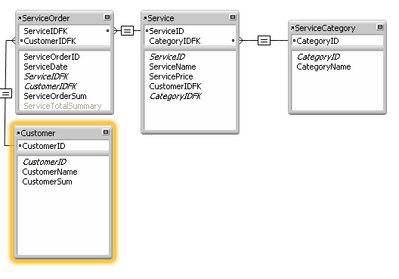

You need a relationship like above. Create a global field to choose the category that is to be displayed.
-jens

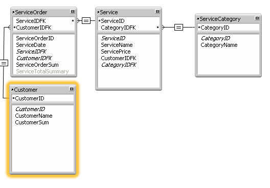

Hi. thanks for your help but i'm afraid i still don't understand how to set this up.
I've read through several topics on global fields but i am not sure where to place certain items.
i want to select the category within the service table so it can be repeatedly used without having to select the category time and again. I want the service to be selected in the line item which also selects the customer id to create the relationship.
I dont understand what the global field should be and which fields it should be related to.
and finally, how can i create an equation to calculate the sum of the line items of each category for an individual patient between a start date and end date.
this is what my er diagram is so far
thanks again
