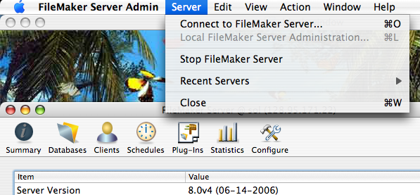

Note: I had been working at the console, and just now connected with FileMaker Server Admin running on another computer.
"Server > Local FileMakerServer Administration..." is not available when using FMS Admin anywhere but the server (requiring physical, or virtual (e.g., Remote Desktop, Timbuktu, etc.) access).
Ken
Yes, the server is set to accept remote connections, and in fact I connected remotely while trying to use Server > Local FileMaker Administration... The word "Local" I suppose is a good clue as to the scope of the functions that section offers, although I don't know why those functions couldn't be extended to FMS Admin when used remotely.
Eh, say what? You don't connect remotely to the server from Local Administration. Remote connection is a separate toggle thathas to be checked in the SAT Tool.
Steven
Sorry, my wording was bad. What I meant is that:
"I connected remotely, *then* tried to use Server > Local FileMaker Administration..."
I had very strong doubts that connecting to the server first would allow Local Administration to work (although it was something I'd never tried) -- but you asked if I allowed remote connections, in response to my prior post about "Server > Local FileMakerServer Administration..." So I was responding (albeit unclearly) that, yes, I had allowed remote connections, and in fact did connect remotely (and then looked to see if Local Administration might be possible).
Ken
The remote connection is for use when the SAT Tool is not on the same machine as the server. There are restrictions about its use in conjunction with WAN's and firewalls. The Local Admin is for running the SAT Tool installed on the same machine that is the server.
