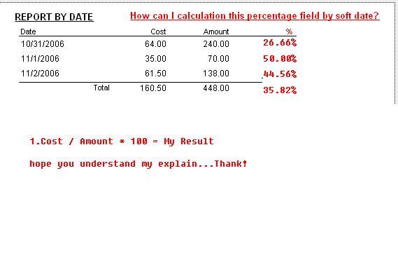

Hi all,
My problem is when I soft by date, how I calculation the cost field / amount field *100 = My percentage field result.
Thank for your reply!

I made two changes to your file. First, modified your calculation to be a Summary field using the Fraction of Total option. Second, I modified your Number formatting to display as percent (you had currency with a custom character) and only two decimal points. But, see the attached file since this is always easier.
Soft_Report_Problem.fp7.zip
Hi John, thank you for reply my problem. I think my question is not very clear to you. What I want to do is when I soft the date report, the percent field will calculate after I soft the report figure.
Hope you understand....Thank!
Thank John....this is the one!
