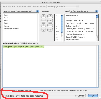

In stead of wrestling with an explanation, have I made a template for you, here above is a red marking of the crutial issue in this method, enjoy....
NotEmptyValidate.zip

I'd like to make sure I understand what you're doing so that I can make it work myself the next time. If you don't mind, I'd like to ask a few questions:
1. In the jpeg you attached, it appears that the line you circled in red reads "Validate only if field has been modified." In my version (FMP 8.5, XP), that line reads "Do not evaluate if all referenced fields are empty". Am I looking at the right thing?
No you're not I'm afraid, the dialog you refer to is the one belongning to straight forward calc's not the dialog found when applying a calculated validation.
