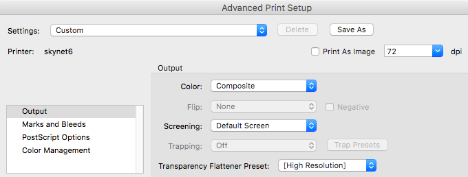

I realize this is 7 years ago but I am putting my answer out here for the benefit of others.  my guess is that it is a print setting on your computer.  The same thing happens on my mac.  After nearly a year I figured out from the print window (which may be custom for adobe products) to click "advanced"  from there is a checkbox to "Print as Image 72 dpi" I unchecked that box and things are good now.   Same is likely on the PC.

  • In the Print dialog box, click Advanced.
  • If a custom printer settings file exists with the settings you want, choose it from the Settings menu. Otherwise, choose Acrobat Default.
    Note:
    To learn more about an option, select it. A description of it appears at the bottom of the dialog box.
  • If normal printing doesn’t produce the desired results, select ***Print As Image*** and choose a resolution from the drop-down list."
