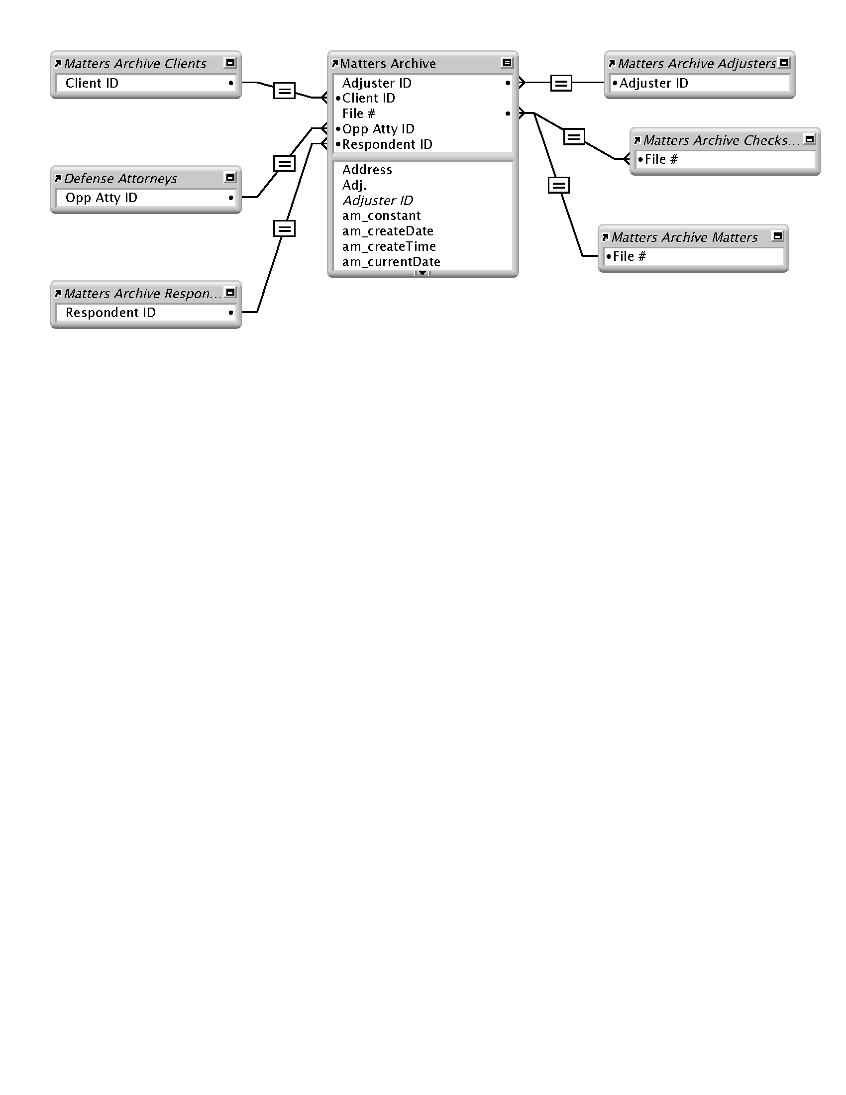

  1. I use a multiple table (formerly multiple file) structure to track work on a matter. For years I have archived that matter by "exporting" the data into the file via a number of lookups to pull the data from multiple tables into the archive file. This stored the data in a static format since we wanted it to show accurate information at the time of archiving. That data would not change. I would then delete the matter from the active matter database. If we were done with our client (all their matters were completed) we would delete that person as well. After reviewing comments in this forum it appears what I should have been doing was marking the matter as "completed" and the client as "inactive" instead of exporting the info and deleting it. In other words I should have been doing a "soft delete". I am trying to figure out how to make a matter "inactive" and make sure that I freeze the information pulled from the other tables at the time it becomes inactive. If the person moves after I have archived the completed matter I don't want the person's new contact info to go into the archived matter. But if the matter is still active I do want it to show the current and up to date information as it changes. I have attached a copy of the graph from my former archiving structure. Also is there a sample file out there that shows the implementation of a "soft delete" so I can see it in practice.

  8. I originally started a version of this ERD in 1990. There is no more Claris Works on Mac OS Lion to open it with so I'm starting fresh. Actually I am currently using a multiple file database to track information in a law firm that is based on a similar structure, but I have decided to redesign it with FMP 12. After pondering this for a number of days I have come up with the structure in the attached diagram. I know that there are other ways to do this, but this is what my brain comes up with. I would appreciate any input or questions. We use this to track clients, their court dates and court venues, the adjuster and attorneys who are assigned to the file, the expenses associated with the file, and case notes that describe contacts with clients, doctors, attorneys. Multiple forms and letters are produced. I want to add in a "tasks" function that associates "to-do" items to the matter. Again, thanks for taking a look. GTA ERD.pdf
