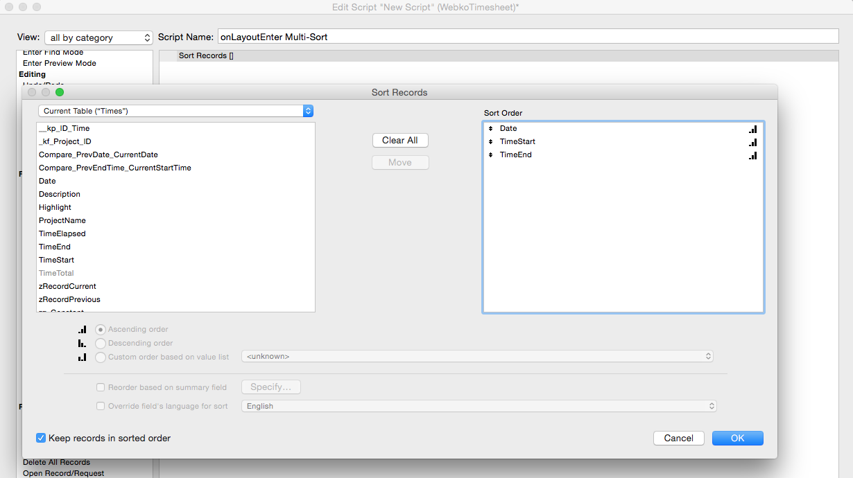

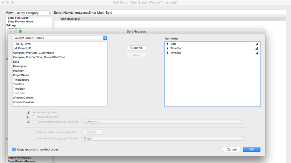

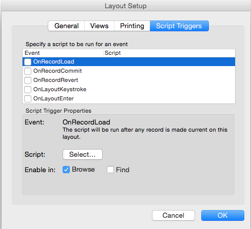

You are correct - just moving to the layout won't sort.
You can attach a script to the layout that gets triggered OnLayoutEnter that can do the sort  - in Layout Mode, Layout Setup - Script Triggers
And you can do multi-sorts - the Sort Records script step works the same as Apple+S or the toolbar
See attached
webko!
Thanks - I was using "Sort Records by Field" - which only allowed one.  Made that small change and everything is working!
