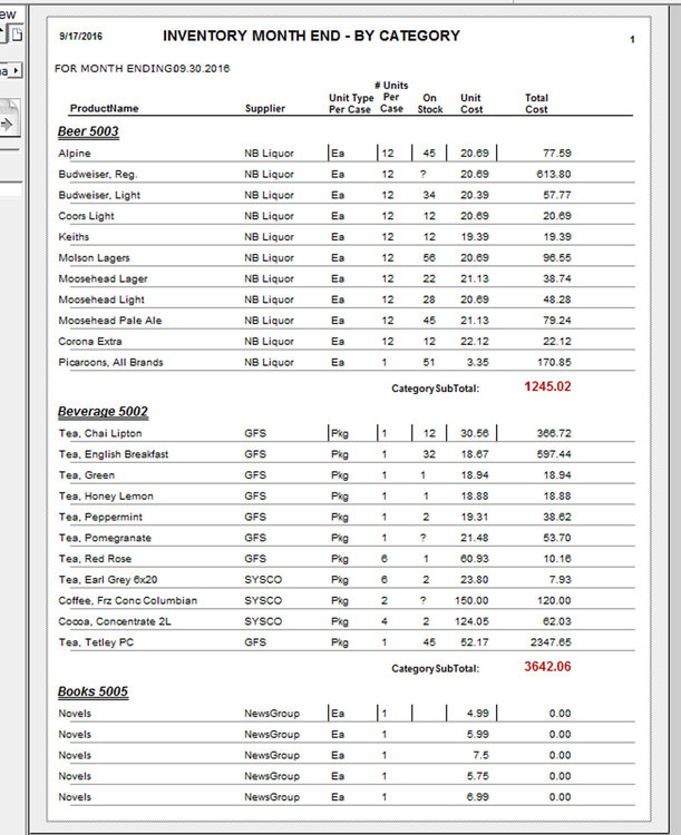

I have a food inventory database that has a month-end final report food-type category as it relates to how they are expensed in my accounting system e.g. Food 5001, Beverage 5002, Vending 5010, etc, etc. There are 12 expense categories altogether accessed by a Popup Menu.
The month-end report has a Sub Summary field “CategorySubtotal” that provides a department total value based on a sort by the Category food-type field.
Works very well as a printed report however, once my chef confirms that the report is an official end of month reporting of his inventory I am having a hard time determining how to save each of those sub summary amounts to variables for the purpose saving to another table.   The table is then used to develop month-end food cost and asset adjustments.

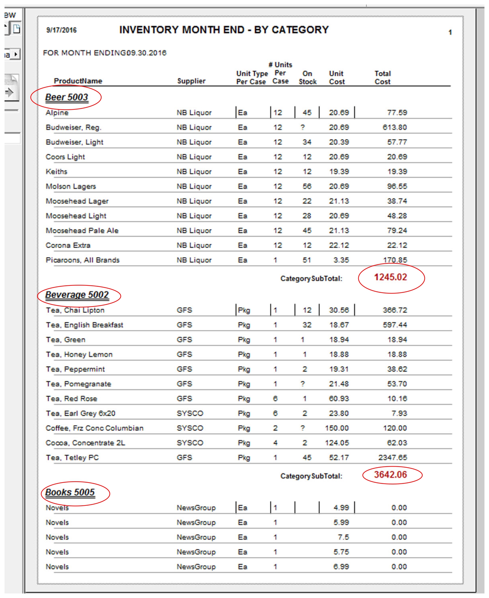

Sorry, may have misrepresented what I was looking for, unless I just cannot seem to fathom it out.  The Fast Summaries as I understand them relate to extracting counts based on a search criterion, but all I need are the individual SubSummary headings and their subtotals (highlighted above) saved to either a variable or field for further processing.
No, the technique is designed to go over any sorted found set and get the sub-summary values (the numbers in red in your screenshot).
