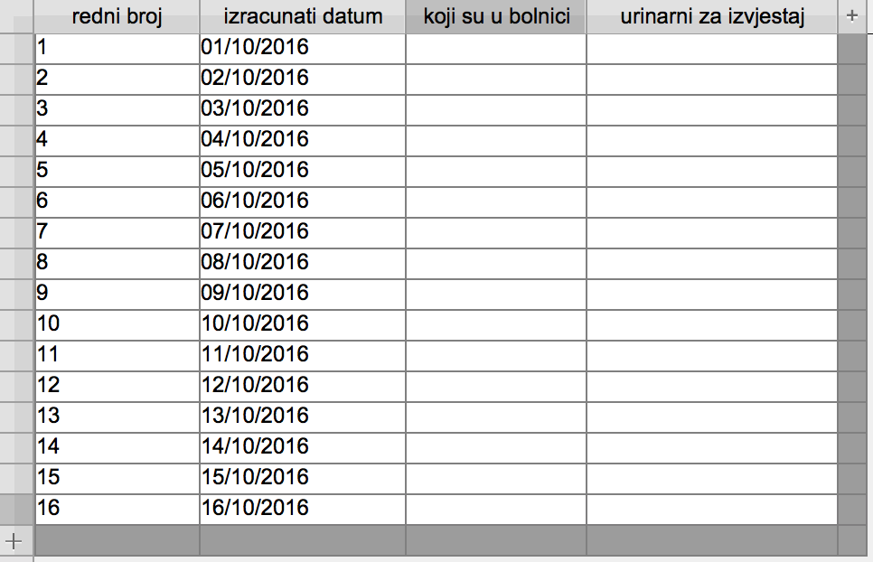

So to get to the point, my records get admitted at some date and they get dismissed at some date and they have some events occuring or not (checkbox with values 1 or blank). I need a report with number of records with each event checked on a given day (so the conditions for each day are: day admitted <= day tested and (day dimissed => day tested or day dissmissed = "") and event = 1. The report should list days from 1 to 30 (or 31 or 28/29 for February). I got stuck with a table, not being able to fill the fields with calculated results... (check photo)
Any ideas, suggestions? Thanks in advance.

Okay, then. The first thing that needs to be clear here is this: if you want your report to show every day of the selected month, even if you have no records for that day, you will need a reporting table with 31 permanent records numbered serially and global fields for the month and year to report on. The relationship between this table (Days) and your existing table (Records) will be:
Days:cDate ≥ Records::DateAdmitted
AND
Days::cDate ≤ RecordsDateDismissed
where cDate is of course a calculation field =
Date ( gMonth ; SerialNumber ; gYear )
Then you can count the related checkbox field in order to get the number of events that should be shown in each day's record.
Your reporting script needs to look at gMonth and gYear and omit the appropriate number of records from the report (e.g. the last 3 records if it's February in a non-leap year).

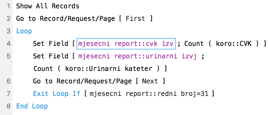

Just to get things right, I made relationship, and I made a script to populate the table. The script will be executed upon call (pressing the button for report).  I made this simple just to check if I'm getting it right, I'll set "omit" for shorter months later on...
Sorry for posting scripts as a photo...
Thanks a lot. Just as always, this cleared few new things for me...
No, that's not a good idea. Those two fields should be calculation fields, and they should calculate automatically. Otherwise if two users are viewing different months at the same time, one of them will see incorrect data.
Yes, calculation works better, thanks again.
