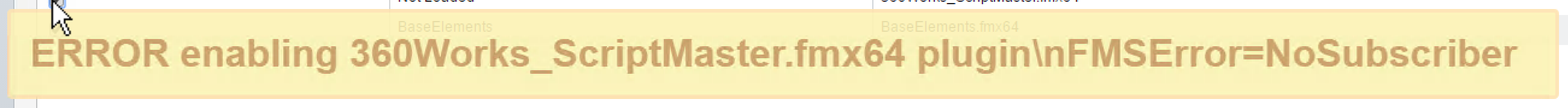

finally got 5.03 from the download page
works on a Mac
on Windows 2012R2 I get this
591ad6fe5b3ca_ScreenShot2017-05-16at11_21_10.thumb.png.bbac600b39ef856aa38cb9fb87d77ede.png
and I am getting a 701 eror in the server log
please may we have an update??
Edited by john renfrew
Trying to install 5.03 on Windows Server 2016 Std and getting error 812 " The host's capacity was exceeded, try again later" and crashing the script engine.
