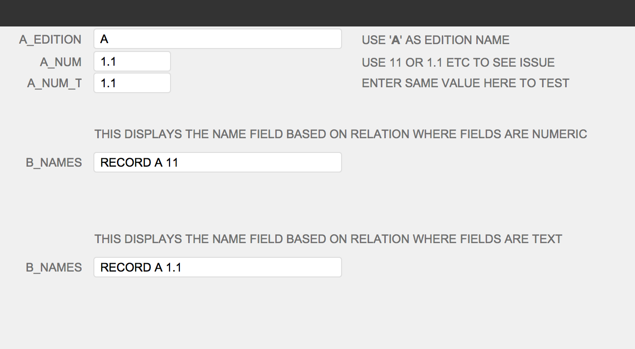

OK, I have made a file with two tables, A and B.
In table A I want to insert an Edition (I only made the edition 'A' so anything else will not match).
In table A I also add the number I need and what this is all about. There are two fields in table A where you should put the same value (like 1.1 or 11 or whatever).
The A_NUM field is numeric, the A_NUM_T is a textfield. I have made two relations, one for each.
The result on the Table_A layout should be the name of the related file. You can view both results in the Table_A layout.
The values in Table_B are unique, no duplicates.

When I open your file on my system, I see the actual value in A_NUM field as 1,1 not 1.1. Similarly, in B_NUM field in record #14 of Table_B I see the value of 1,1. A string containing a comma is not a number, unless your file is set to use comma as the decimal separator. Your file is set to always use the current system's setting - so the question is what is your OS using as the decimal separator.
Added: I see that the file's settings are to use a comma as the decimal separator. I believe you have entered "1.1" into a number field on a system that requires a comma to be used as the decimal separator, and therefore the value is indexed as 11 ( same as any string value would be indexed using only digits, the minus sign and the decimal separator - see the attached demo).

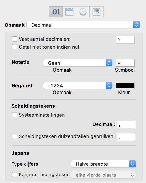

I'm not using the systems settings as far as I know - but the separator is a comma. Is this the cause of all this?
You are using the system setting (look under File Options > Text). Formatting the display of the field is irrelevant here. The problem is that your field contains a non-numeric value (see the addition to my previous post).
Ouch! I was looking at the wrong place for that setting then. I assumed that field formatting overruled any and all preference.
No, it only affects the way the field is displayed on the layout. Keep in mind that you can add another instance of the same field to the layout and format it differently.
