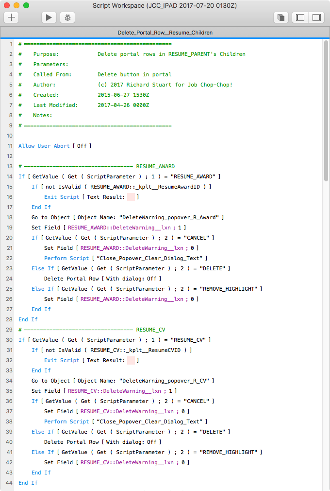

In my current, overly verbose script, I use a button that hands off to separate popover button inside the portal that conntains a warning message and Cancel and Continue buttons so users can't accidentally delete portal rows.
I attached the portion of the current script that shows two of the seven children tables; you can get an idea of how repetitive the code is. (The Delete Warning fields are flags so when a portal row is selected, its fields' contents turn red--through conditional formatting--after the initial script button is pressed, showing users which row they're about to delete.)

In any case, what I said earlier still applies: if it's a button, then clicking it will not change the current selection. If you're doing something in-between that will cause you to exit the current portal row (such as opening a popover), then Filemaker will not know which portal row to delete.
