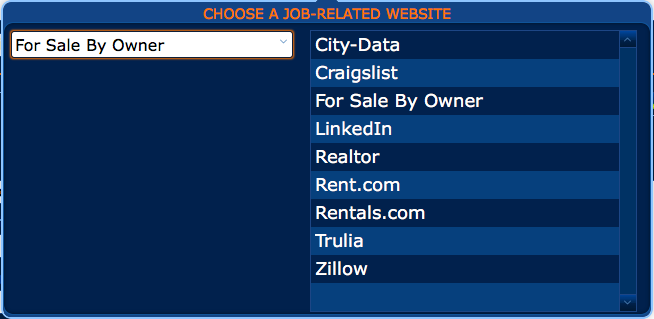

A change of aesthetics in a solution is forcing me to change from a portal to a pop-up menu and I don't know how to re-code the existing script; the portal works fine so I know the relationships are good, just that I don't know how to script a pop-up to pull the URL from a related record then use the OpenURL command.
The related table has two fields, URL__txt (which holds the actual URL) and Value__txt (which has the name for the URL). In the portal at right, a button--made from the Value__txt field--when clicked, uses the OpenURL command to open the URL stored in URL__txt. So far, so good.
The pop-up menu on the left, in the local table, has all the values of Value__txt; I use a global field for temporarily storing Value__txt's value.

Couldn't you simply place the portal in a popover and keep the existing functionality?
If you really must go with a popup menu, then define your value list to use values from the URL field, also display values from the Value field, show values only from second field. That way your global field will actually contain the selected URL.
Consider also http://www.briandunning.com/cf/908.
Thanks. Yeah, I wanted to keep it inside its popover (you can't tell from the screenshot but it's a popover) but what can you do. : S
