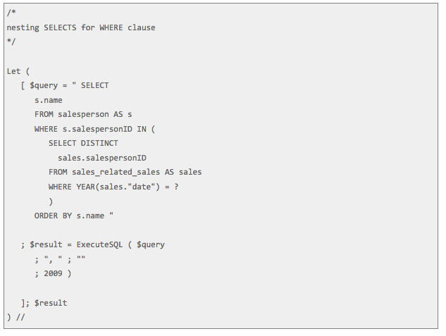

And this to succeed
Edited by LAIRY
To complte : from https://filemakerhacks.com/2012/10/19/the-missing-fm-12-executesql-reference/
10 hours ago, LAIRY said:
And this to succeed

I didn't think the Let would treat the query any differently but it was worth a shot.  Unfortunately I get the same result using the Let method.  First I tried nesting my SELECT inside of WHERE IN but that resulted in a "?".  Next I tried using my $SourcePubList variable (the results of my previously directly inserted SELECT statement, except formatted with single-quotes and commas.) inside of WHERE IN.  Still no dice.
I'm curious how the example statement should function.  In a WHERE IN, shouldn't the values be presented in a single-quote, comma-delimited format?  If we do no formatting to the query results (i.e. field/row delimiter in ExecuteSQL) how does WHERE IN know how to treat each separate value?  If I tried to do that in a normal SQL environment, the interpreter would treat all of these values as one.  This concept blows my mind.

Hello,
The first pdf explains that in the « IN » order, with dynamic parameters, each item must be enumerated separately.
In our case, as Kevin Franck state in 2012 in The Missing FM 12 ExecuteSQL Reference
 « If the list is TEXT, then the values, must be enclosed with single quotes (‘abc’,’def’,’ghi’,’jkl’). These values will be automatically be quoted as needed, if you nest another SELECT inside. »

This did help, thanks!  I was able to understand even though it is not all in English.
So what was happening in my case is that my query seems to have been working while nesting SELECT within WHERE IN.  The problem was the function was taking too long to resolve and the script was timing out.
I was specifying my variables for Let as local variables ($) .  Based off of this I tried replacing them to be as global variables ($$) and the statement resolves 4 times faster.  In the former case my query took over 4 hours and then timed out; and in the latter it now completes in 1.5 hours.
