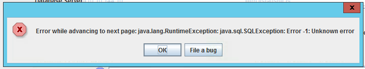

Im having issue regarding configuring Mirror Sync.  I had a working configuration and successfully was able to sync.  Then I added SQL filtering to the setup and again I got correct response.
Then again I wanted to add to my configuration other things but then I ran into a problem:  Error while advancing to next page: java.lang.RuntimeException:java.sql.SQLException:Error -1:Unknown error.
There is no way for me now to configure any more.  I have removed my configuration without any luck and also I have installed Mirror Sync again.  Nothing works.
Any advice?  Are there any hidden settings files to remove or?

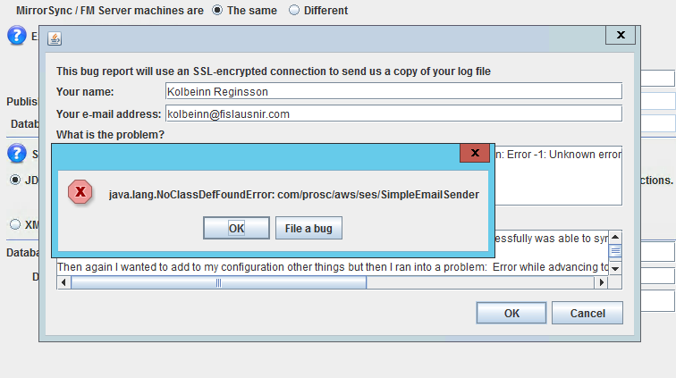

Now this issue seams to be an Java issue.  Now I got an error only when I tried to report an error inside the Configuration tool.
What java version is needed?

Fixed.
The reason for this issue was, the startup layout had only global fields and no records.  I changed the startup layout and bingo.
