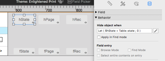

On the report layout in the header and footer there are some button objects each has a Hide object when calculation that declares a $variable by use of the Let function that evaluates when a script is running.
Once setup the script uses the $hState, $hPage, and $hRec and compares them to the same variables in the footer - to determine if a summary part spans multiple pages.
