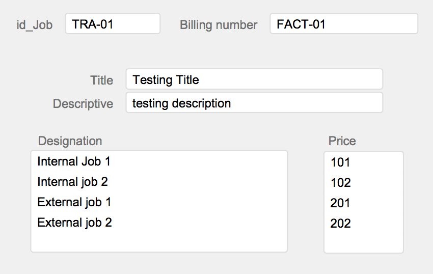

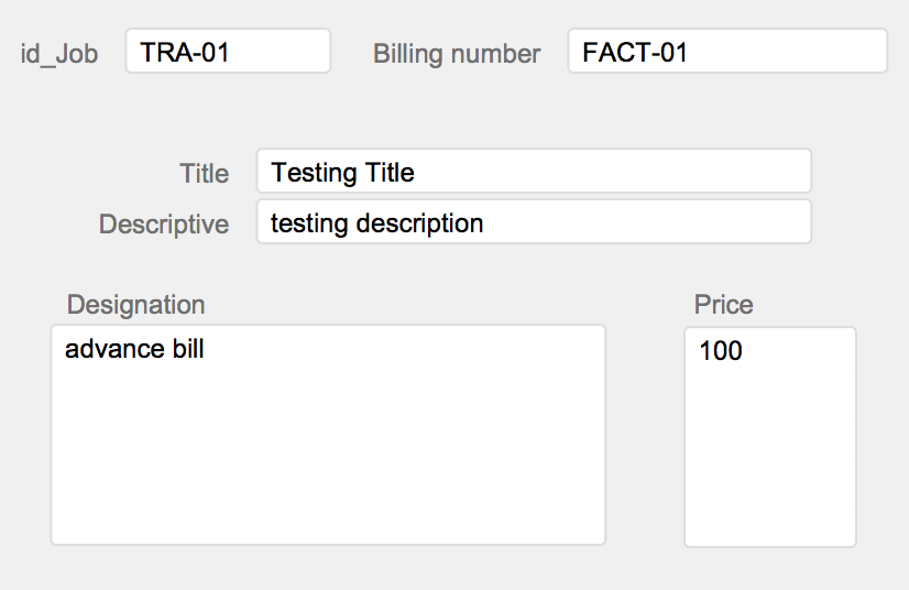

The 1st script is for the deposit invoice. Il creates a new bill (FACT-01) wich mentions the advanced payment

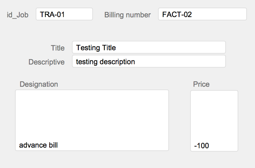

The 2nd script generates the final bill (FACT-02). It must contain details of the bill. But the bill does not contain the details; Worth, the details are injected on the deposit invoice ((FACT-01)

The "problem" is that four tables are linked by ID_JOB.
In the script, if you use display related records and then fill the field with define field ... you always will fill the same record (the first one in this example)
At the first bill, no problem, but when creating the second, the link doesn't work well.
So after displaying internal job, you have to display billing for working on the last record and then you can fill it.
