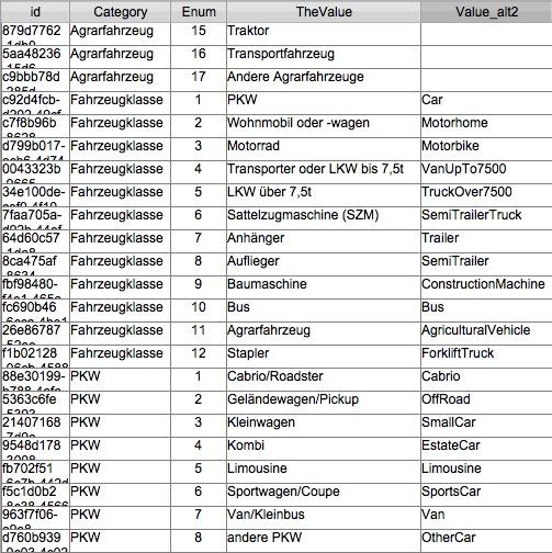

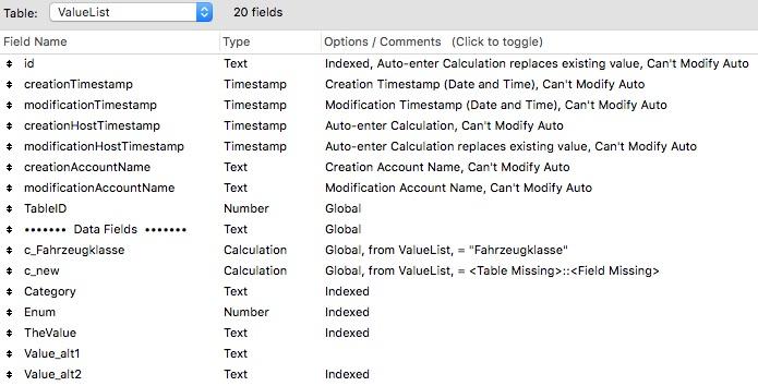

In the example that Matt gives, you set up a ValueList table containing all the category/value pairs of your whole solution and make a self joined relationships to that table for all value lists you would like to see. Keys are text constants that you define that hold the exact category names. Please see below the attached ValueList Table.jpg definition and the ValueList Values. In my solution I have a "Fahrzeugklassen" value list and two other value lists that are dependent on that list. For example, when I choose the item "PKW" from the Fahrzeugklassen list, I would like to see all values of the PKW value list and insert the Enum of that value into my table.

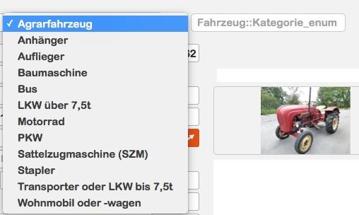

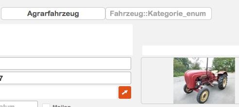

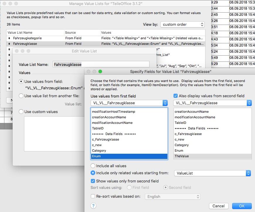

In my table Fahrzeug:: I have two fields, Fahrzeug::Fahrzeugklasse_enum and Fahrzeug::Kategorie_enum that hold the Enum numbers of the ValueList::  When I click on the field Fahrzeug::Fahrzeugklasse_enum, I see a list of all Fahrzeugklassen (see picture Fahrzeug Layout 1). When I choose one, it inserts the corresponding Enum number of ValueList and displays ValueList::TheValue. That works using a self joined relationship with a global "Fahrzeugklasse" as the key (see below TO.jpg and Value List Definition.jpg).

So, this is what to do:  You go about it exactly the same way as before (for a normal value list):  Set up a 1) global field in your ValueList:: table, add a 2) self-joined Table Occurence of ValueList:: using the previously defined global field for the relation, add a 3) number field in your Layout table containing the value that the user will choose (my table name is Fahrzeug::) and 4) add a value list the same way like before.

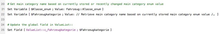

The only thing slightly different is the global field in ValueList. It mustn’t be a calculation field anymore, but a normal text field — still global. It’s value needs to change whenever the main category value changes. That is: When the user changes the main category (say, from «Car» to «Agricultural Vehicle»), or when the user goes to another record. This can easily be handled with Script Triggers. In my case «onObjectSave_MainCategoryField» and «onRecordLoad_myTable» are doing that job. Both script triggers call a script that updates the global field in the value list table (see picture).
