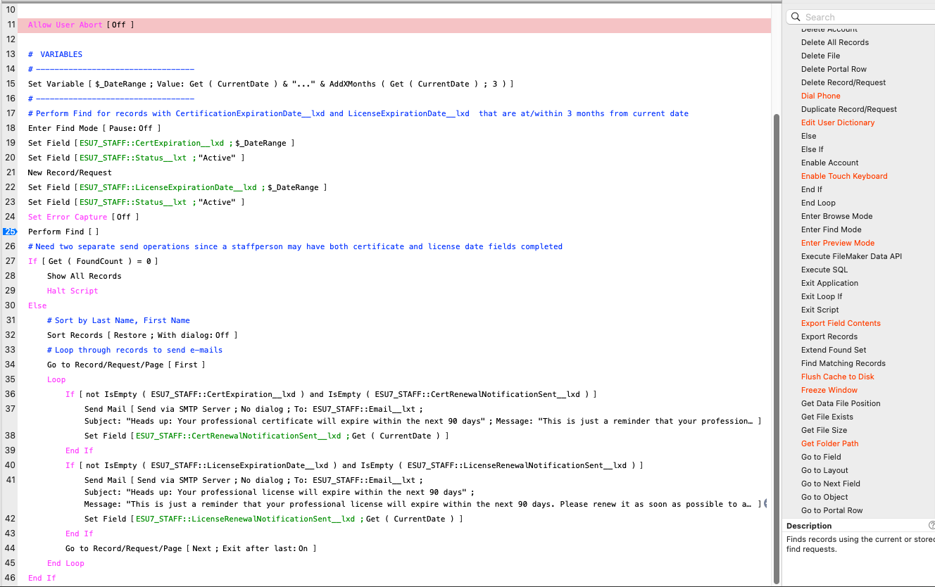

We're running FM Server 19.5.1.43 with a hosted file that I set up to run as a scheduled script that would send e-mails to people notifying them that their certificate or license needs renewing. However, it fails every time it runs. As a troubleshooting step, I disabled all the script steps, created a new one with a Perform Find on  CertExpiration__lxd field (with * as the operator), and attempted to run the script again from the server. It failed again.
Here ya go:
2022-07-15 11:10:23.967 -0500    Information    146    fmp19    Schedule "Cert_License_Expiration_Notice" run now by "esu7".
2022-07-15 11:10:23.967 -0500    Information    689    fmp19    Schedule "Cert_License_Expiration_Notice" has started FileMaker script "E-mail Notification that Certificate/License is up for Renewal".
2022-07-15 11:10:24.138 -0500    Information    645    fmp19    Schedule "Cert_License_Expiration_Notice" scripting error (103) at "ESU7CRM : E-mail Notification that Certificate/License is up for Renewal : 25 : Perform Find".
2022-07-15 11:10:24.154 -0500    Information    645    fmp19    Schedule "Cert_License_Expiration_Notice" scripting error (101) at "ESU7CRM : E-mail Notification that Certificate/License is up for Renewal : 45 : Go to Record/Request/Page".
2022-07-15 11:10:24.170 -0500    Information    644    fmp19    Schedule "Cert_License_Expiration_Notice" completed; last scripting error (101).
2022-07-15 11:10:24.170 -0500    Information    126    fmp19    Schedule "Cert_License_Expiration_Notice" scheduled for 07/16/2022 06:00 AM.
One quick one to reduce errors is on line 44 (above go to record next )  add this step, it will remove the 101 errors.
Exit Loop If ( Get(RecordNumber) = Get(FoundCount )  )
Error 103 is Relationship Missing you need to go to the correct context so you need to add Go To Layout
You may try to delete the Enter Find Mode and Perform Find steps, save the script and re add these and try again.
