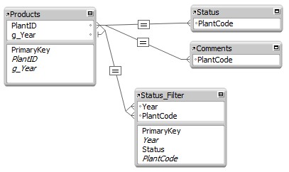

There's a products table and a status table. The products table contains a list of unique items, and the status table indicates the status of the product for each year. My layout is based on the products table and contains a global field to select a year, which returns the status for that year in the product portal. The problem is that my product list won't stay sorted. I've written a script to sort the records on layout enter, but when I add scripts for other things on the layout the list reverts to its unsorted state. Do I need to add a step to every script to make sure the list stays in sorted order?

Hi, I'm sorry for not being more clear. The layout based on products is a form view, and the layout contains a portal to display those records. Since the portal draws from the same table as the layout, I don't have the option to sort or filter it.

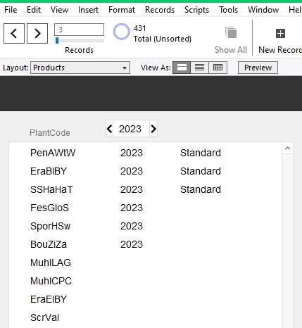

I have a script to sort the records on layout enter, and it works. However, if I enter find mode to constrain the record set, the list becomes unsorted again after I 'show all'. Screenshot below looks near the bottom of the list:
Constraining the found set does not change the sort order. Showing all records does. At what point of constraining the found set would you need to use Show All Records, and for what purpose?

I can think of quite a few reasons, but it could be that I'm not approaching the issue from the right mindset. Here's a standard scenario:
  1. I want to look at our product list and review their status for this year and next year, so I go to the layout above. Upon loading the layout, a script runs to ensure the records (and thereby, the portal) are sorted by product name.
  2. There's only one product or group of products I need to review, so I enter find mode to narrow down the records displayed. Potentially, I even perform a find for the year and the specific status.
  3. When I've reviewed the information, I need to get back to the full list of products, so I select 'show all' from the top navigation bar.
Would I be better suited adding controls to my layout instead of relying on the 'show all' button on the default top navigation bar?
This is where you will lose your sort order. You could prevent this by using a script instead of the built-in command - a script that shows all records and sorts them. You can run the script using your own button, or from the Scripts menu, or - if you take the time to create a custom menu set - using the same button as before.
Alternatively, you could perform the find in a new window, and return to your original, already sorted, full set by closing the current window.
