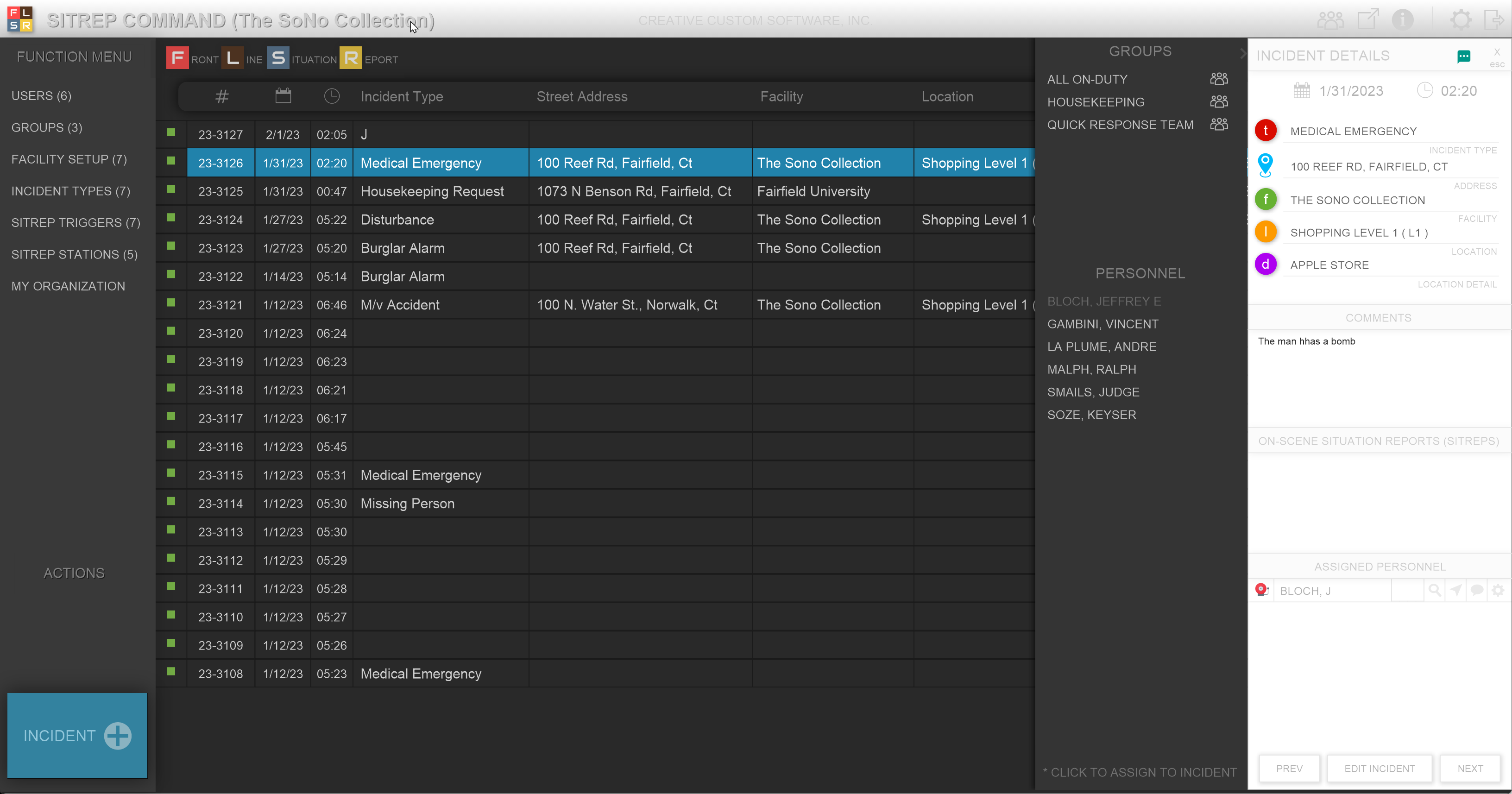

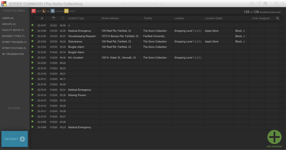

I'd like to have a button (bottom right) always visible but I don't see a way to have it be independent from the slide beneath it. Because of the position of the button, FM assumes it to be part of the slide. As an experiment, I grouped if with a rectangle with the top, left corner being outside the slide, but as you'll see in the attached video, the slide initially conceals the button even though the group is to the Front.
Any way to accomplish this?

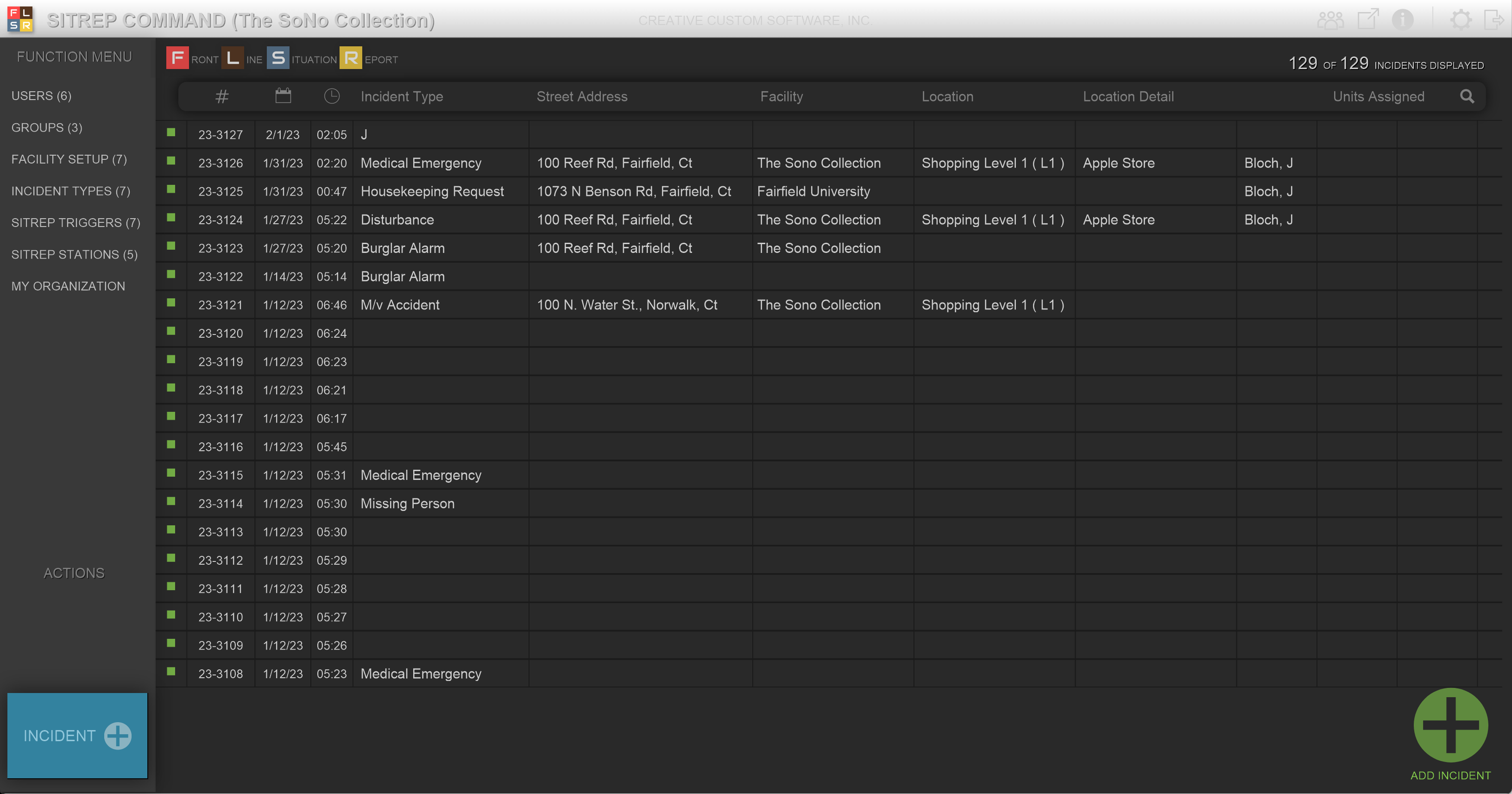

Thanks, I'll have a look. In my pics, the green plus button is meant to stay in front of the slide which is open in pic #2. In the video you'll see it happening.
