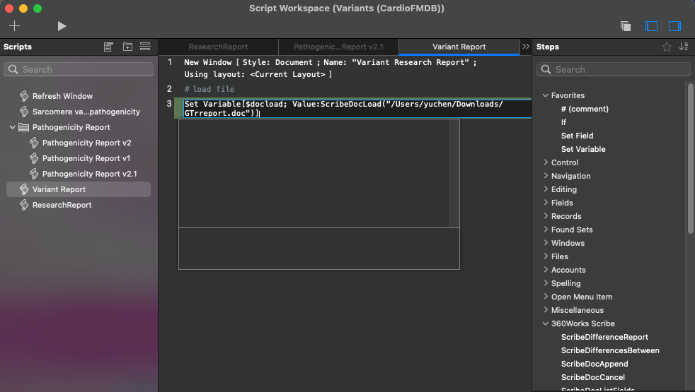

Hey,
Thanks for your quick response. I copy and paste the directory and once I hit return the whole row 3 is gone(disappear)  - refer to line 3 of the code.Greenshot2023-03-1413_47_02.png.a8563e531990e7b3c7f44f43341e818f.png
I am super confused right now, is it because I want to use this in a local filemaker pro?
Thank you for answering in advance

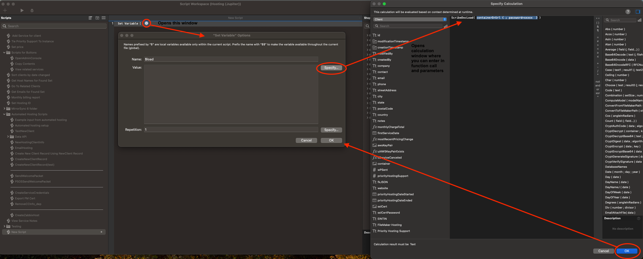

Hello,
Scribe wouldn't have any impact on the script workspace so I am not sure why your script step isn't persisting. In general there should be a settings wheel next to the Set Variable script step that will open a window for you to define the script step. After naming the variable click specify next to the calculation field. This should open the calculation window where you can access Scribe functions. Once you have input the parameters, click ok on the calculation window, and ok on the script step definition window and the script step should persist.
