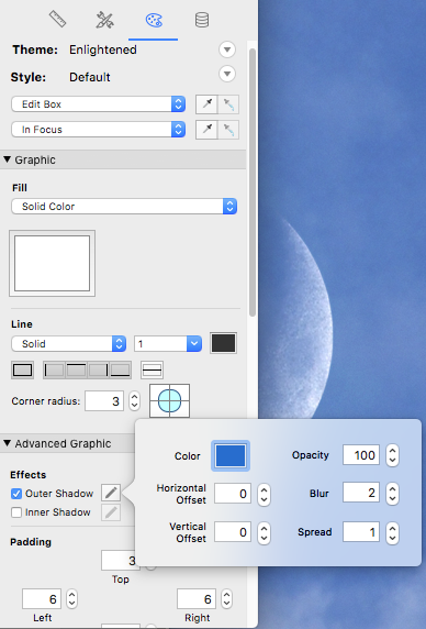

When I click into a field in either Browse mode or Layout mode a light blue glow appears around the field border.  I have seen posts that said that you can’t get rid of this blue glow because it is a built-in feature of FM to indicate that this is the field that currently has focus.  It is very annoying and,  if you can’t get rid of it, is there a way to at least change the colour from blue to something that better suits your theme?  Below is an image showing what I am talking about.

This "glow" is Outer Shadow. You can change its appearance or remove it altogether by going into Layout mode, selecting the field, switching to 'In Focus' state and modifying the settings here:

Thank you very much.  That does the job.
