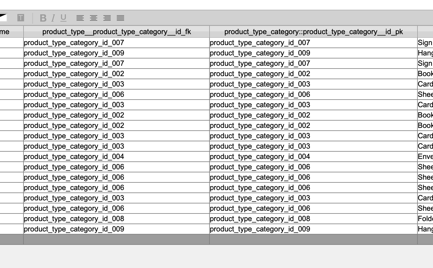

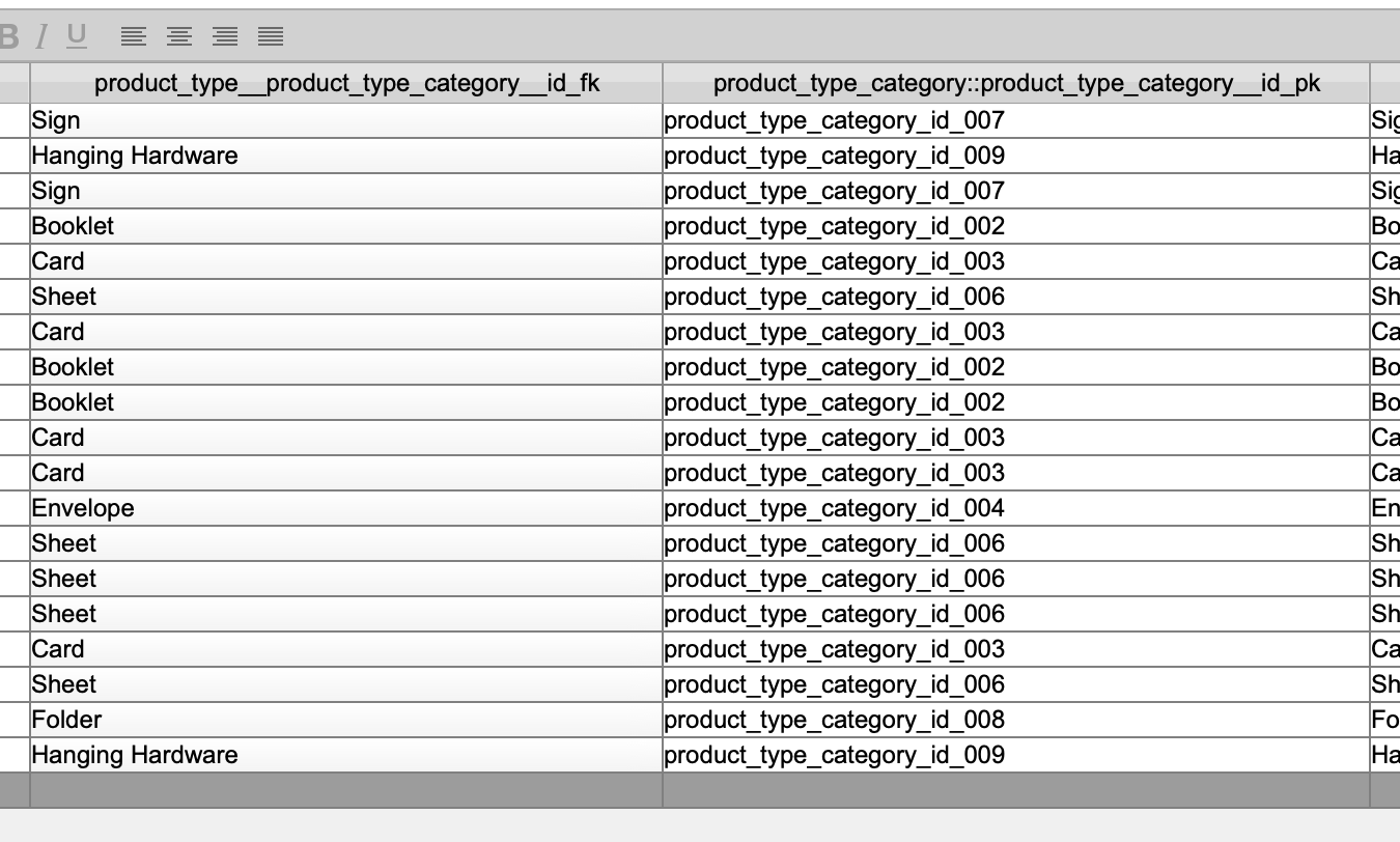

I have discovered this behavior:
Table View will utilize the behavior of the FIRST instance of the fields configuration. If the field is first configured as a Pop-up - that is what Table view will present: no matter HOW you configure a second instance of the field or WHEREVER you place that second instance. You can change how that first field is configured at any time (change to Drop down List) and Table view will respond accordingly. Again, this is what I have experienced fiddling with this.
I have not been able to present, in Table view, both the "first field" value, and the "display second field value" at the same time by attempts of TWO field instances. The solution I have decided upon is when I need to see "first field", I will change the pop-over to a drop down list in Form view. This will show what I need in table view. And, as Comment suggested, I will place in Table view the field from the related table: this has not required I place the field and hide it in Form view, I am simply adding the field in the "MODIFY..." table view dialogue. This will allow me, in Table view, to COMPARE if the FOREIGN KEY matches the related PRIMARY KEY in the other table.
The reason I need to compare fields like this, is it sometimes occurs when Primary Keys are prefixed with words - and then the words are changed for some reason. I fully understand UUID and am not advocating one way or the other as to the choice to use those instead of prefixed IDs. What I am dealing with is the situation when receiving data from other sources where the keys are already provided and the prefix need to be changed due to conforming to a different schema. It is in these cases where I have found a want/need to see both the FOREIGN KEY value and the PRIMARY KEY value of a relation.
Using Comments suggestion, and fiddling with this a bit, I have found a workable solution. It would be nice to add two instances of a field and configure their display differently, and be able to view this in Table view.
What can be done instead is what I have settled in on doing, but it requires access to layout mode and the effort to toggle the Control Style between Pop up & Drop Down List.
I have attached screenshots to show the different views you can get in Table view, but requires choosing either Drop down or Pop up in Form view to achieve the display. IDEALLY, I would like to see all THREE bits of information in Table View:
1. The Foreign Key stored data (ID_FK) from first field
2. The related Display data (Name) from second field
3. The related Primary Key (ID_PK)

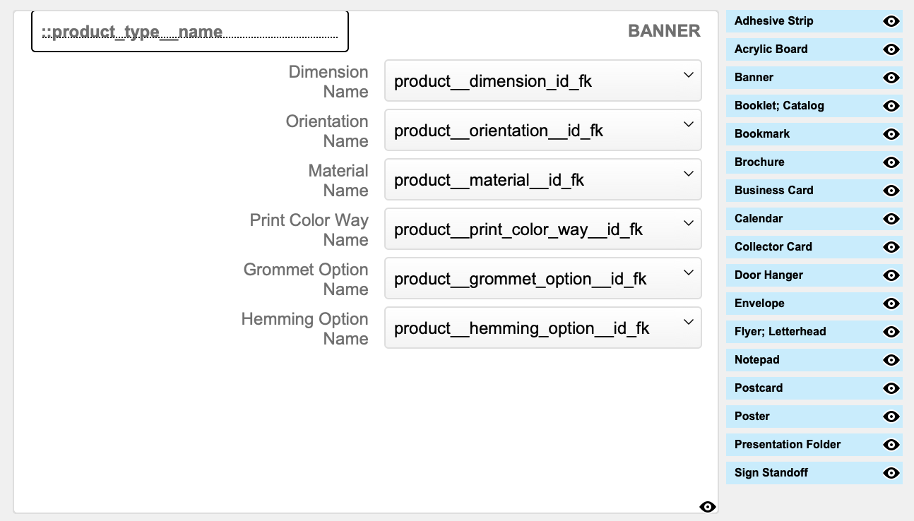

I just came across a "need" to show labels only in layout mode and hide all other modes. I have a stack of "panels", for the lack of the right word, and each panel has like 10 fields. Gaining access to any particular panel in layout mode was a pain as I would have to move them one-by-one off to the side to find the one I wanted, work on it, and put all the panels back in position. I needed a way to grab a panel in layout mode, but they were all perfectly "stacked".
So, in layout, to be able to access one of 10 panels stacked, I created a text label for each of the 10 panels that I could select the label "handle" and bring to front to work in layout mode. It took me forever to find a way to show in layout mode and hide in all other modes my "label" handles.  Get(windowmode) = 4 does the trick. However, no clear documentation about this. There is some info about WindowMode 4, but not in a manner that makes it clear I can use it in layout mode to achieve what I wanted.
See screenshot attached.
Once again, thank you for your time: I really do appreciate it!
