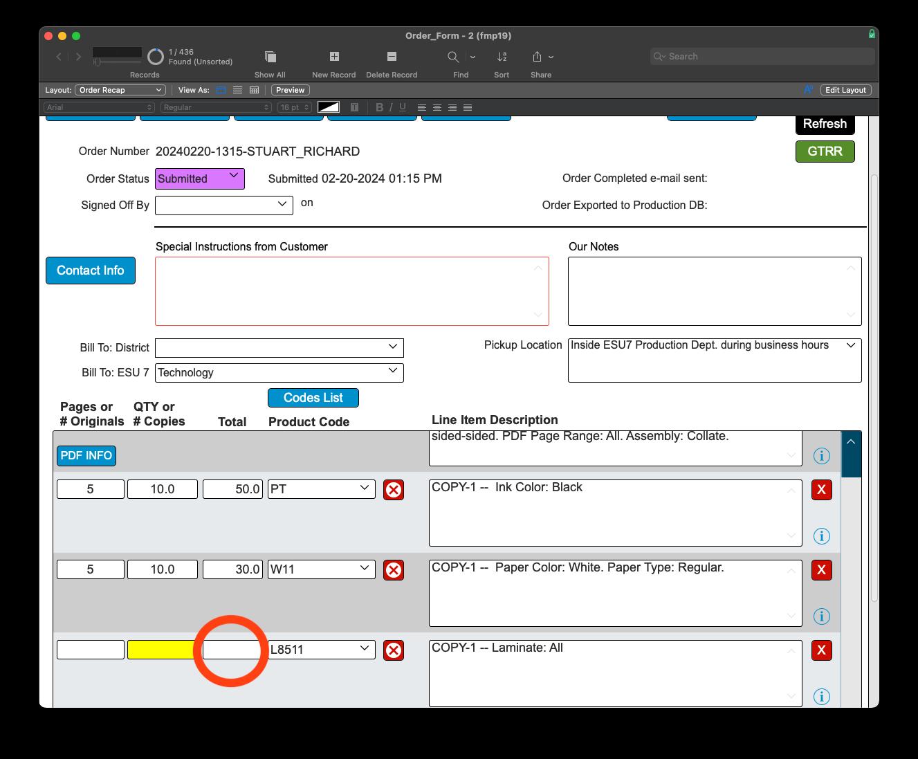

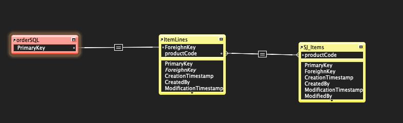

Please refer to the attached.
Total is a calculated field that looks refers to Pages or # Originals and QTY or # Copies. (It has a bunch of different calculations based on Product Code, so that's why the one for W11 looks funky.)
Within the child table, I'd like to automatically copy/calculate the value from the Total field of records that have a Product Code of W11, into those records that have a Product Code of L8511; so the calculated value in Total for W11 is also in Total field in records where the Product Code is L8511.
I thought of using an ESQL calculation in a discreet calculation field that looks at the foreign key from the parent, "finds" the record in its found set with a Product Code of W11, then outputs the value from the Total field, but I can't nail the syntax for the calc.
Maybe another T.O., with a foreign key join, would work but how would I "see" the records with W11 in the Product Code field?
As always, TIA for your help!

I don't know. If I had to guess, I would say this is a "kit/component" problem. Looking at the screenshot, it seems they ordered 30 white pieces of paper (W11) that need to be laminated (L8511). They entered the quantity in the W11 item and they want it to be automatically copied to the L8511 item.
Correct, Comment. The children table is joined to yet another table so using the third table's foreign key would prevent same-name codes from being included.
