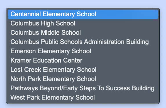

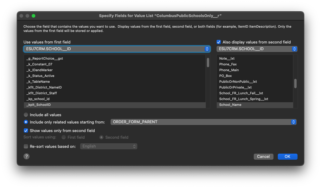

In the attached, you can see a related value list setup for a pop-up menu. When inactive, the field shows the primary key, not the school name (from the second field.) I have the Override data formatting with value list checkbox ticked in the the Inspector (Field section) but doesn't alter the menu's display, so what else do I need to do to display the school name instead of the primary key when the field is inactive?

I am not able to reproduce the problem.
Try toggling the two settings, Include Arrow… and Override data formatting off and on again. Or see what you get using a new instance of the field.
That worked. Thanks!

Sorry, I should've written a new instance of the field.
