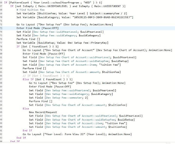

I want to create a script that finds a category "Tuition Fee" in a portal and then when i add a subject the summary amount of added subjects will divide into two (2) and then set to the two "Tuition Fee" fields. What i mean is the divided amount will set to the  two fields also named "Tuition Fee"

Here are my script, but i cant set an amount in second (2) sem. Maybe i am wrong for finding the field for 2nd sem in Else If step that is why it did'nt work
image.png.aae67fcbab1f72f3f261fa11ec8ee703.pngHere

Could I get an Image of the Table occurrences involved, where the relational structure is shown? It seems like you kind of avoid using multi-predicate relational key? Is it because everything is tied together, meaning that you not are utilising breaking up in smaller TOGS?
Then ....I have noticed a seemingly error? Where is the $uuidYearLevel variable initiated?
What is confusing me here, is why you have both:
Dev Setup Fee Chart of Account::
...as well as:
Dev Setup Fee::
I would say that if only one semester record is found, then set the split in halves value in the first found ... and then duplicate the record, the other case being there is already two records found - then make a scripted replace in just the field where the fee is in?
