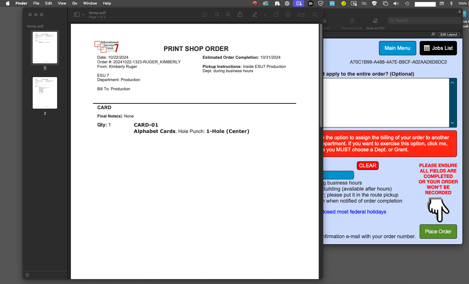

I'm using a script to temporarily store, then print, a document from our server (FMS v21.0.2.202) to a remote printer. (Script attached.) The problem is, just at the end of the script--using the Print command--the file opens on the end-user's computer via their .pdf viewing program. Is there a way to prevent (or circumvent) the opening of the document using their .pdf program so they don't see the document at all?

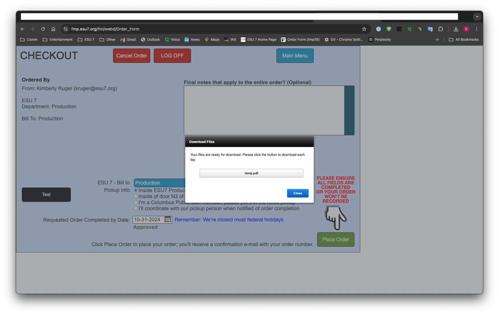

I celebrated too early: Even with the Automatically Open switch disabled, not only does the document appear in the Web browser in a new tab, but the customer is asked if s/he wants to download the document. (See attached.) Neither event happens in the FileMaker Pro client, so it's something that interacts with WebDirect. Back to playing with the file.
That is the expected behavior of Save Records as PDF in WebDirect:
https://help.claris.com/en/pro-help/content/save-records-as-pdf.html

Sorry, I don't follow your explanation.
When you print something, you are supposed to get the same result as shown in Preview mode, whether you go into Preview mode beforehand or not. The reason to go into Preview mode is to get user's approval before the actual printing. I see no such attempt in your script. It just dumps the PDF into the temporary folder (in FMP) and proceeds to print the same thing on paper. The printed result will be the same if you eliminate the PDF step.
Note also that printing directly is not supported in WebDirect:
Quote
In FileMaker WebDirect:
  • This script step creates a PDF in a new web browser tab. To print the PDF, use the web browser's controls.
https://help.claris.com/en/pro-help/content/print.html
