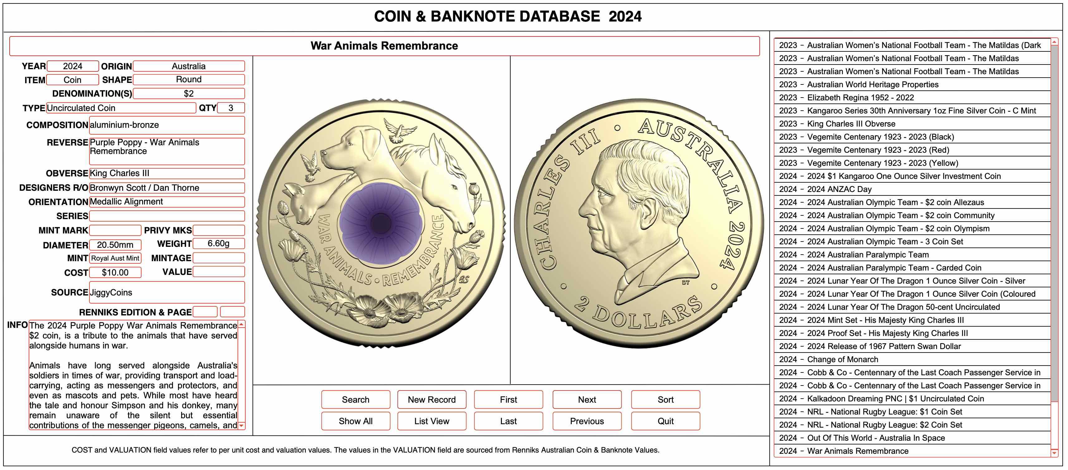

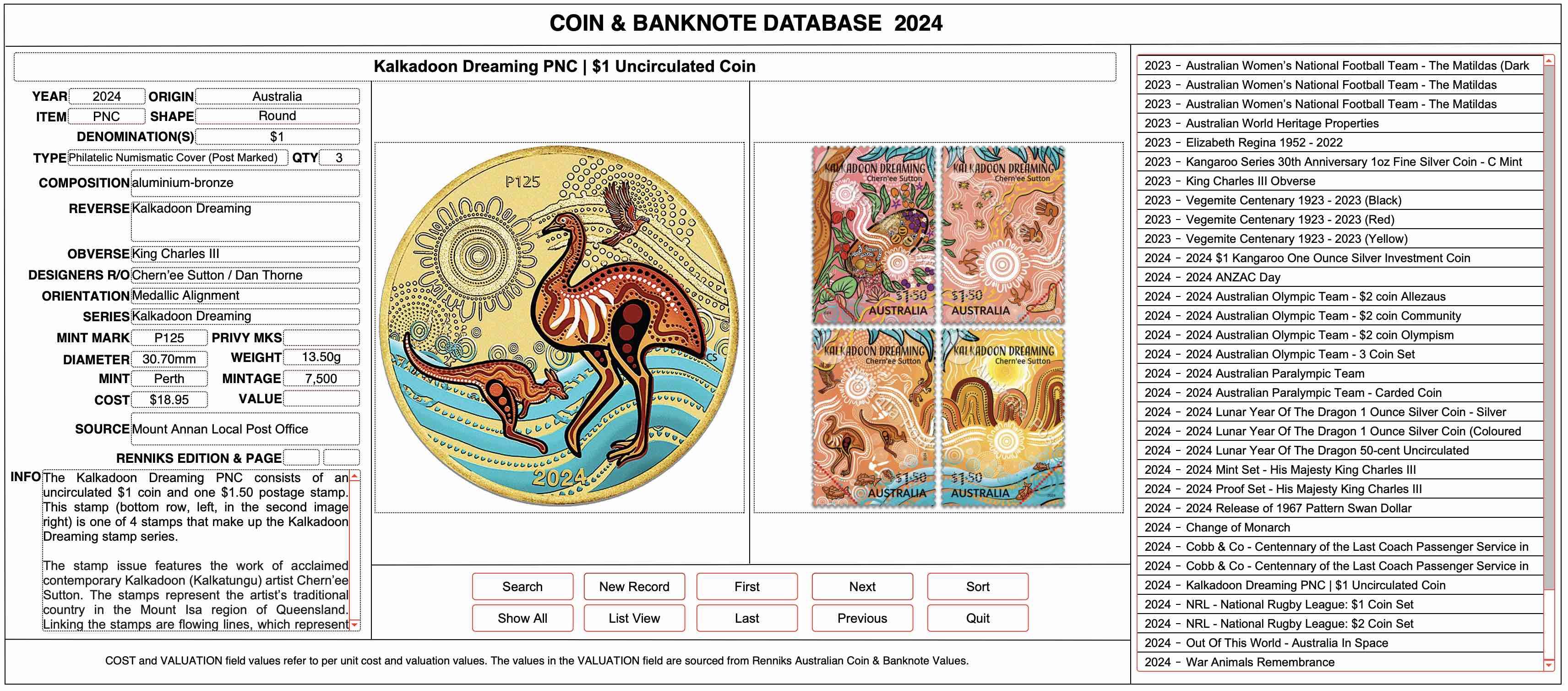

Am a newbie! I have just added a portal to a coin database I created to speed up navigation and display search results. Initially, when I open my database, all fields are displayed with a solid red border (thickness of 1) as added by me. If I click on a portal row to display a record, the border of all records changes to a dotted line; the red border disappears. Can someone tell me what is happening, please?

I have attached 2 images. Image 1 shows the database when I open it. Image 2 shows the database after I click a record in the portal. Am I right in assuming that this is what happens when using a portal?

I redid the portal in a backup file and still this issue resurfaces. Be interested in your ideas as to why this is happening. I note that, if you click on the record after you have selected it from the portal, the red borderline of the fields returns.
