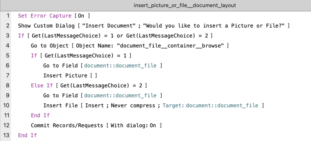

I have a script that works on a table/layout called "document". It inserts either a "Picture" or a "File" depending upon what the user selects via a dialogue prompt. The picture or file is being saved to external storage and I can verify that these inserted files exist in storage by viewing the external storage file system. So far, so good.

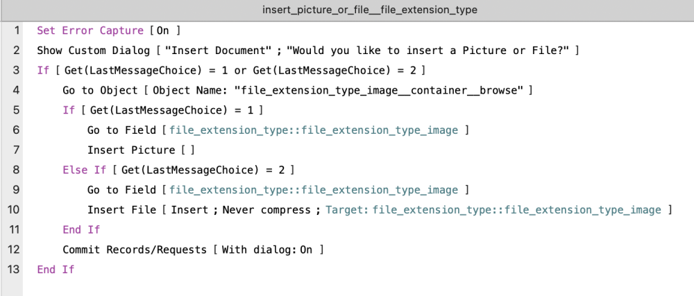

I duplicated this script and modified it so it could work for another table/layout called "file_extension_type". With this modified script, I can insert a "file" -  but not a "picture".

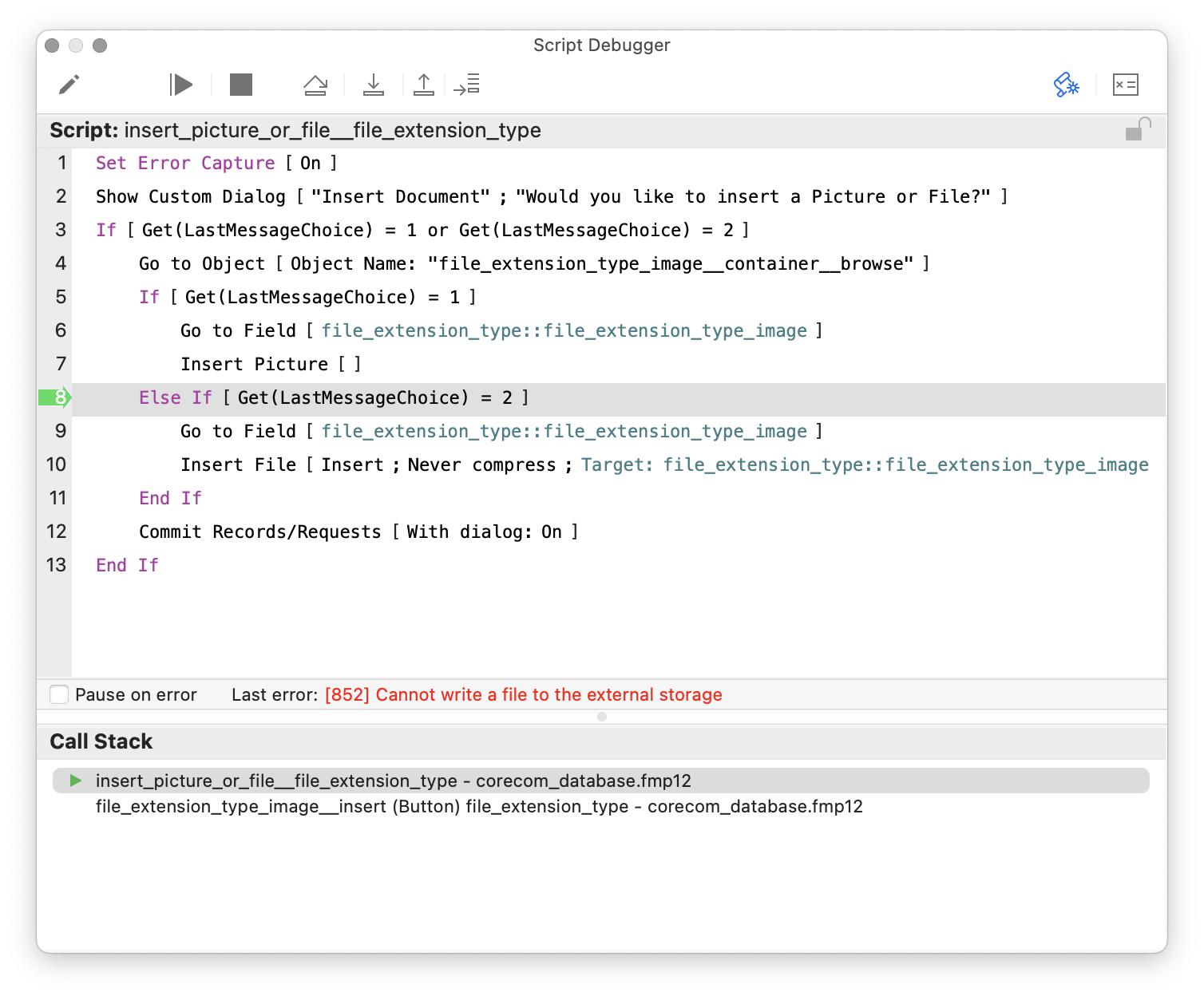

When using script debugger to troubleshoot - I do receive an error message when trying to insert a "Picture", but not when I insert a "File". The error message is: "Last error: [852] Cannot write a file to the external storage"

  • Insert Picture or File script for Document layout (seems to work fine);
  • Insert Picture or File script for File Extension Type layout (does NOT work, the problem script);
  • Script Debugger Error Message when running problem script;

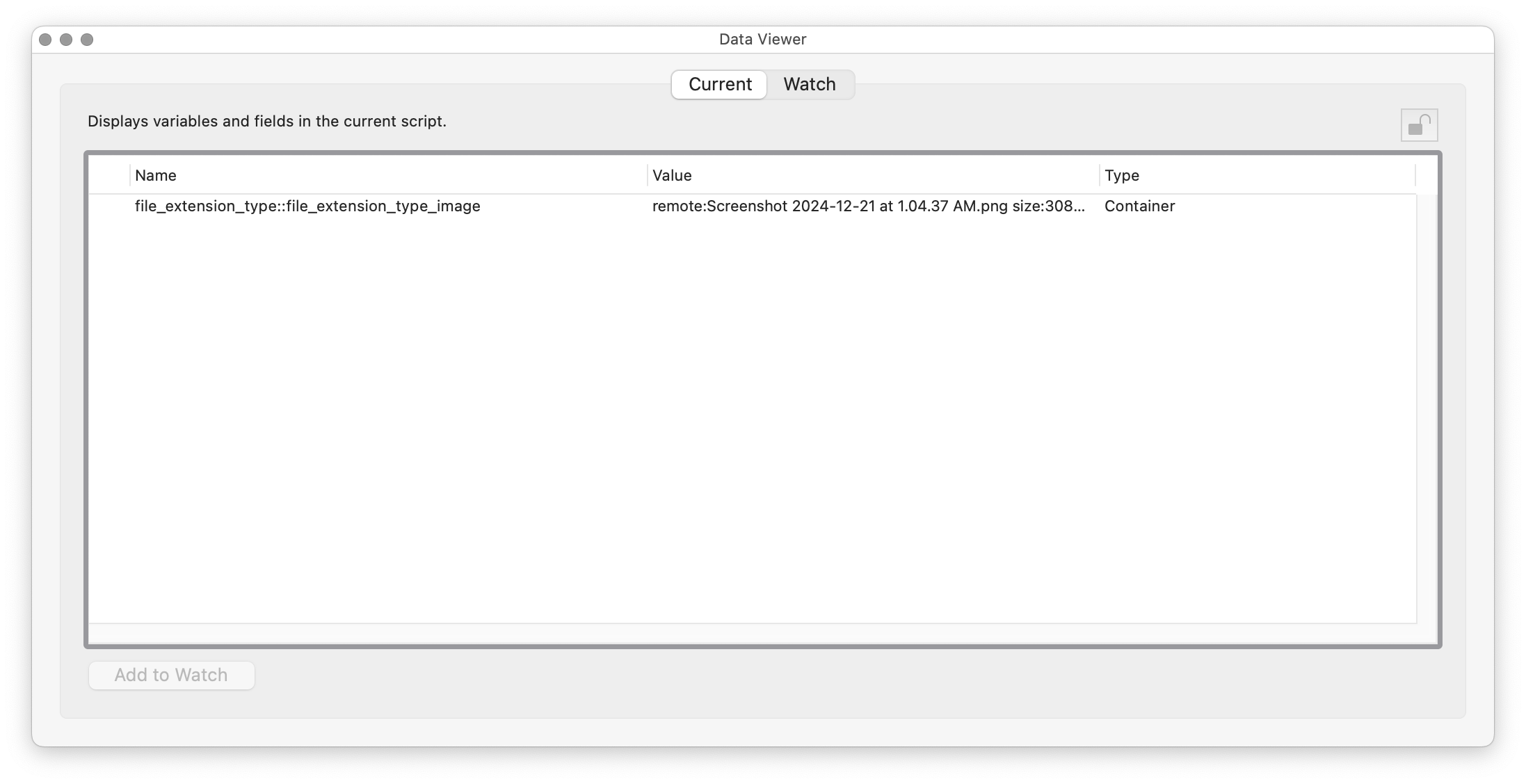

  • Data Viewer screenshot when running the problem script;

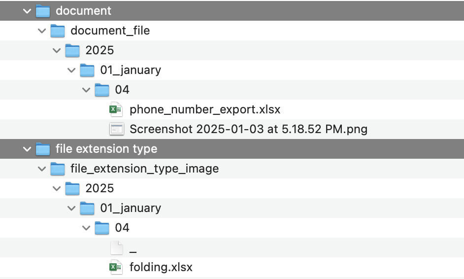

  • External Storage File System (showing files are being written to storage for BOTH scripts - except "picture" type when running problem script.

I do NOT suspect external storage permission problems - as I am able to write files to the location (except "Picture" type files for the "File Extension Type" script.
