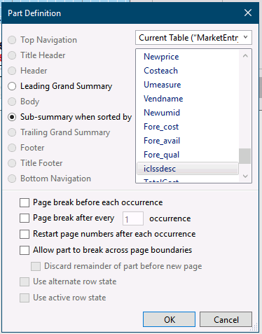

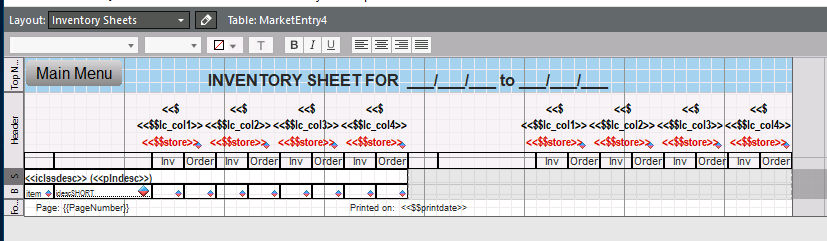

Yes, we're printing in columns, items are sorted by about 6 fields, and we have a sub-summary header with "iclssdesc" (item class description) as the break/sort field.  It prints them all in the correct place, but we need it at the top of any RIGHT side column when the group continues from bottom left to top right.
We are re-working a system that I wrote in Visual Foxpro 20+ years ago, and that had a switch in the report forms that you could force the headers to reprint at the top of columns if there is a carry-over.
Wondering if there's a way we could COPY the field on the LEFT side, to the right side, and hide it somehow, when it's NOT printing the right side data?  But don't know if there's any way to know that, or how the print engine works that way.
