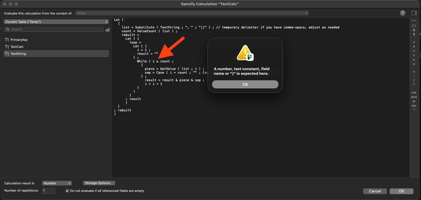

Need help getting this calc to work: replace every other comma with a pilcrow
Hi there:
I'm close—I just can't figure out what I need to get this calc to work:
Attached is a screenshot of the error message (from the DataViewer) and of course, the file; the calc is "remarked out" so I could preserve it and close the editing window.
I'd sure appreciate the help. Thanks!

Try it this way?
While ( [
result = YourField ;
n = PatternCount ( result ; ", " )
n ;
pos = Position ( result ; ", " ; 1 ; n ) ;
result = If ( Mod ( n ; 2 ) ; result ; Replace ( result ; pos ; 2 ; ¶ ) ) ;
n = n - 1
result
This is assuming the input is consistently separated by a comma followed by a space.
Here is another way you could look at it, which I think is closer to your attempt:
While ( [
values = Substitute ( Yourfield ; ", " ; ¶ ) ;
n = ValueCount ( values ) ;
result = "" ;
i = 1
i < n ;
value = GetValue ( values ; i ) & ", " & GetValue ( values ; i + 1 ) ;
result = List ( result ; value ) ;
i = i + 2
result
This could be streamlined to:
While ( [
result = ""
n ;
value = GetValue ( values ; n - 1 ) & ", " & GetValue ( values ; n ) ;
result = List ( value ; result ) ;
n = n - 2
result
Just for fun, you could also do:
While ( [
result = ""
n ;
result = GetValue ( values ; n ) & Choose ( Mod ( n ; 2 ) ; ¶ ; ", " ) & result ;
n = n - 1
result
But this one will have a trailing carriage return, unless you change the output line to something like:
Left ( result ; Length ( result ) - 1 )
or:
Substitute ( result & ¶ ; "¶¶" ; "" )
Beauty! Thanks!!
